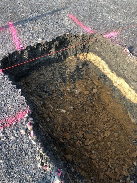

In der Ruine schrieb:
You want to dig a 50cm (20 inch) wide trench 80cm (31 inch) deep in gravel? I would really like to see that. I don’t have a better picture right now, but it should show what you’re asking about... Unfortunately, there’s no scale included, but it was for a frost protection footing.
WilderSueden14 Nov 2023 15:04Yes, if it is well compacted, you can basically excavate vertically. However, it is very sensitive to loads or heavy rain. That’s why it should preferably be concreted immediately and not only after 3 days.
