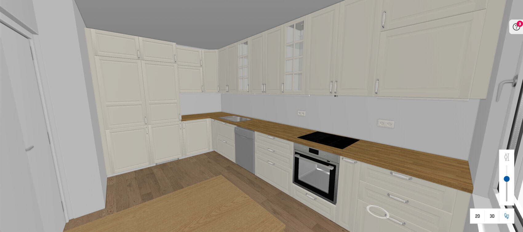

The kitchen layout has changed slightly again, so we didn’t want to recess the entire wall. Instead, we gained about 14 cm (5.5 inches) of passage width at the old vestibule by removing the beam from the old door frame and a section of the wall there. Since the stove has now been moved to a different location, closer to the dining area, recessing the wall on the opposite side would have made it too tight.
The IKEA kitchen will be ordered the day after tomorrow:
Currently, the new interior plaster is being prepared. The new recess will be built with drywall. So currently, we have a semi-open kitchen space and have had the chance to evaluate the open concept—definitely not for us.
