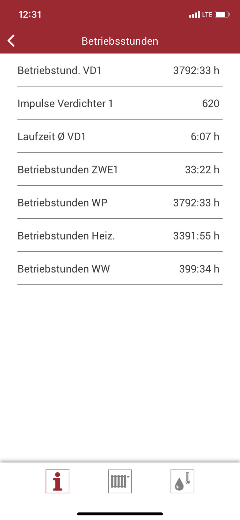

Too bad. I assumed that the network consumption would be displayed as well, like it is for me. Because I suspect I need to optimize my heat pump. The compressor cycles seem to occur too frequently per hour. Nearly 10,000 kWh over 1.5 years is definitely too much without having any expertise.
It seems to be the same heating system as ours. The compressor run time on your system is disastrous. We had the same issue, but improved from 10 minutes to 55 minutes.
With the way your system is set up, the compressor will likely fail in a maximum of 7 years. You’re in for a large repair bill involving four-figure costs. Definitely take action as soon as possible.

No idea if I'm missing something here, but I see the same on my pictures as you do.
Your heating system is really in a bad shape, of course. Ours is now exactly one year old, and I have 615 compressor impulses and an average runtime of 6.x hours.
edit: It's actually 620 impulses
Mobile App: List of operating hours of various components (VD1, ZWE1, WP, heating, hot water) with values.

Well, if there are too many cycles, first check the hysteresis and continue monitoring. It’s not that complicated.
