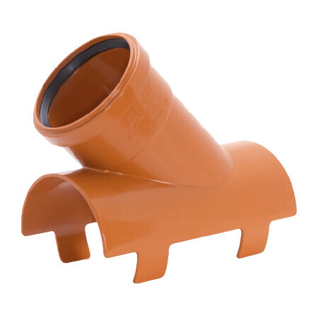

Have you seen something like this in use before?:
It is placed on the existing pipe, the cutout marked, the cutout removed, and then the branch is glued on with a (special?) adhesive. In narrow eaves, that would be optimal, maybe even the only option.
