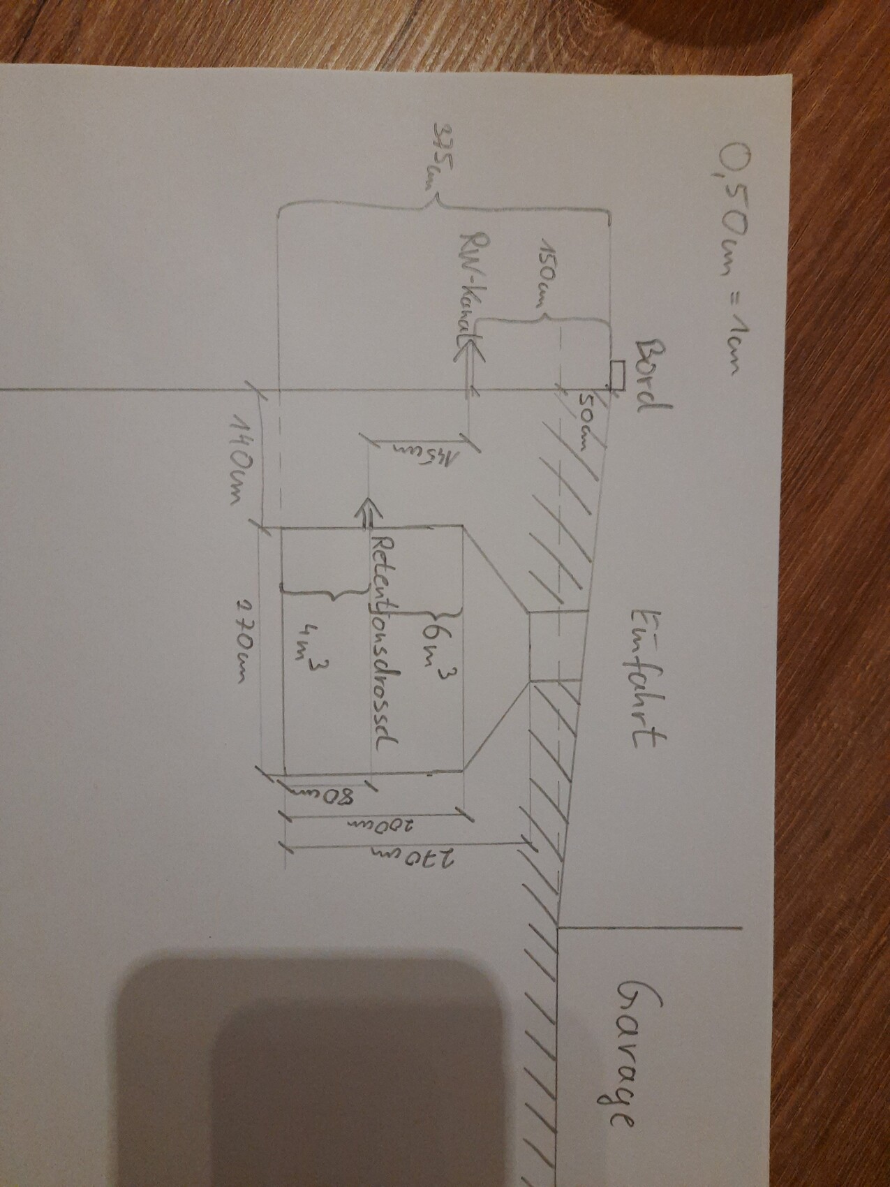

I’m new to the forum and have an interesting question right away. We are currently building a single-family house near Chemnitz and need to provide 3 cubic meters of retention volume per 100 sqm (1076 sq ft) of sealed surface area, as well as a discharge rate of 1 l/s (0.26 gal/s). In our case, that means 6000 liters (1585 gallons) of retention volume plus 4000 liters (1057 gallons) for own use, totaling a 10,000-liter (2642 gallons) monolithic concrete cistern (drive-over capable beneath the driveway).
Since the road is 50cm (20 inches) above the plot level and I want to drain freely by gravity into the cistern, it has to be installed relatively deep underground.
Problem: The retention throttle valve is located below the street’s sewer invert level, so a lift pump is required for drainage. The overflow is positioned just above the sewer, so that does not cause any issues.
The cistern installer suggested building a lift shaft next to the cistern where the throttle valve could discharge at 1 l/s (0.26 gal/s), and to install a submersible pump with a float switch there to pump the water into the sewer. Honestly… that sounds nonsense to me. The pump would keep switching on and off frequently, pumping a small amount at a rate above 1 l/s into the sewer, then shutting off… on and off again, and so on.
My idea was to install a submersible pump with a throttle valve directly in the cistern, draining through a hose into the sewer. I would fix the pump at the level between retention volume and storage volume. This way, no expensive retention throttle valve is needed, no hole in the wall is required, there’s no risk of leaks, and so on… only advantages, in my opinion.

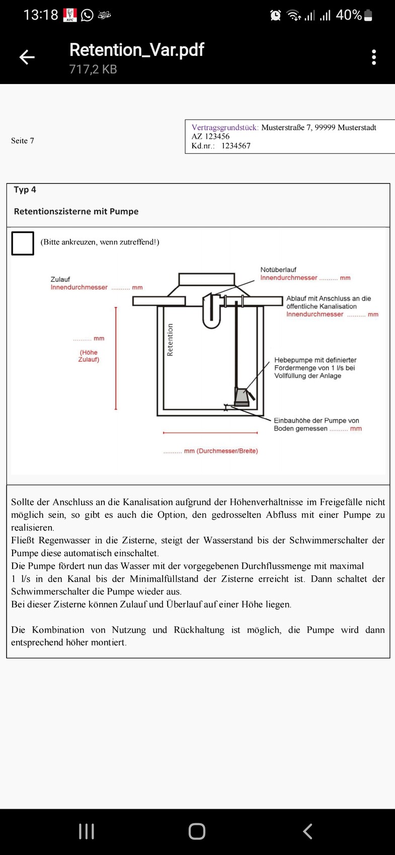

mutzbratem3 Nov 2022 13:19Thank you for the responses and suggestions. Today, I finally spoke with a helpful colleague from the ZWA. He sent me some forms that clarify how I can manage the drainage.
Type 4 applies to my situation. That has cleared everything up. I will discuss the rest with the plumber, as they will design and supply the retention pump.
Nevertheless, many thanks to all of you!
