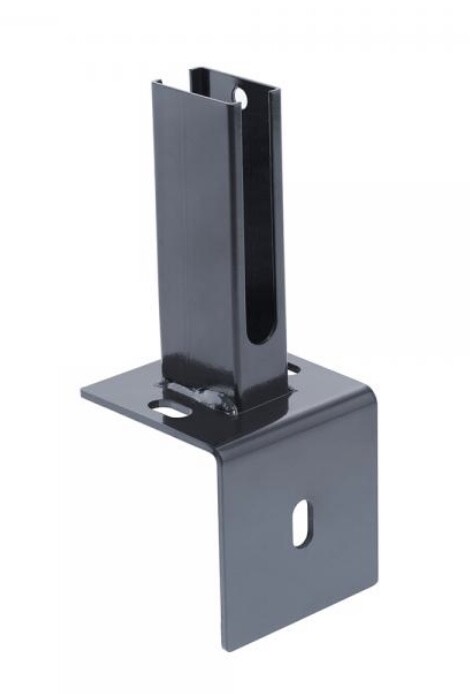

I have already read several threads on this topic, but every case is a bit different. As the headline says, I want to install a 1.8m (6 feet) fence with privacy screening on L-shaped concrete blocks. For this, I ordered various brackets (L-shaped with 12.5mm (0.5 inch) elongated holes) that are specifically designed for this purpose. Now, after reading other threads, I’m a bit concerned about the wind load. Originally, I planned to fix the brackets with 10mm (0.4 inch) heavy-duty anchors and also glue them in. Our L-blocks are 12cm (5 inches) thick and have been cast in concrete. I assume they should be strong enough. After what I’ve read, I would now use 12mm (0.5 inch) heavy-duty anchors. In addition, I would use two rows of a slightly wind-permeable privacy screen. Is this plan still too risky or feasible? The fence will be attached not only to the L-blocks but also extend a bit further. Would it help if I set posts every 1.25m (4 feet) instead of every 2.5m (8 feet) and cut the panels to fit?

And it’s better to use one screw too many than too few. In my original post, I did mention that I ordered the L-brackets for the L-shaped blocks. These can only be screwed from the back or with just one screw from the top. I assumed that this method was the one discouraged.

WilderSueden8 Aug 2023 14:10How much distance is there between the hole and the edge? I would be very cautious with less than 10cm (5 inches) edge distance, otherwise the anchor might cause the concrete to crack.
Hausbauer20218 Aug 2023 14:28The top two holes are definitely smaller. They are centered on the L-block. They measure about 5cm (2 inches). The lower hole is 12cm (5 inches).
