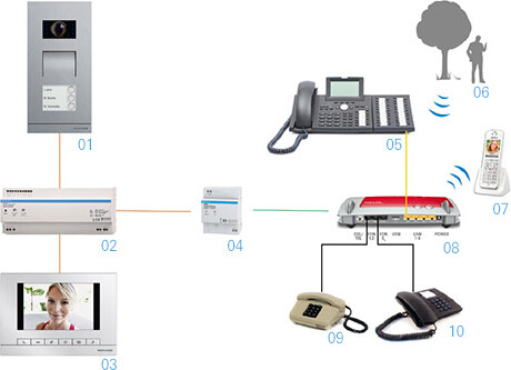

Also checked components from Busch-Jaeger and Ritto and found the following:
Busch-Jaeger
- Busch-Welcome door station €120
- Busch-Welcome mini control unit €118
- Connection to door station
- Busch-Welcome telephone gateway €180
- Connection to control unit and Fritzbox router
- Plus flush-mount boxes, type unclear
- Finally, Busch-Jaeger provides a diagram here, which makes me believe I have identified all components (see attachment)
Ritto
- Acero PUR stainless steel door station €352
- TK adapter a/b €301
- Power supply unit for TwinBus systems (€232)
Busch-Jaeger
