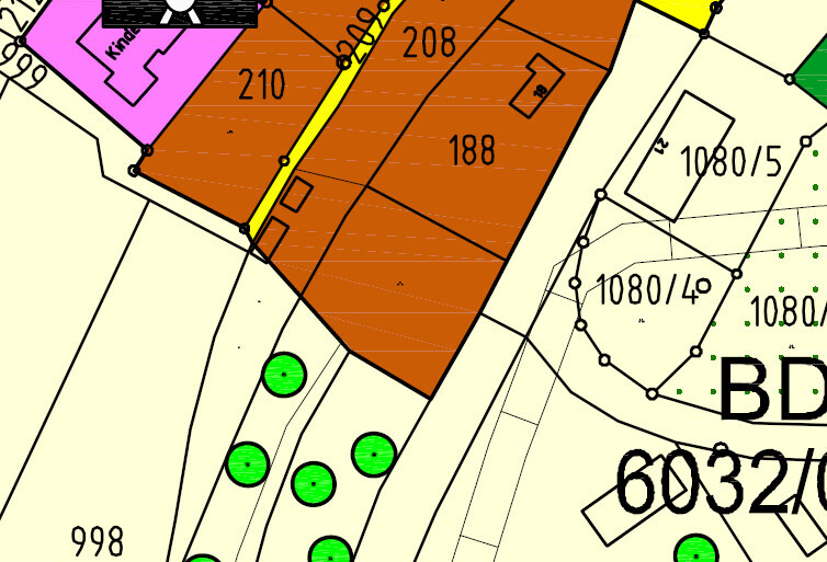

I currently own a plot located in the village area.
Now we are wondering whether it is permitted to build a single-family house on this plot, or if we should play it safe and purchase a plot in the new development area.

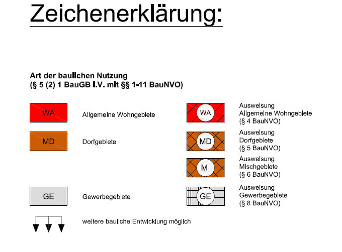

You really can’t make out much from your small excerpts. If the MD (mixed-use area) is only included in the land use plan and there is no detailed development plan (building permit / planning permission), some plots here could be considered as lying in the “outer district” (rural zone). If it is not in the “outer district,” the obligation to blend in with the surroundings would apply without a development plan. If a detailed development plan were to be created—which I find unlikely for the village center, as the little that can be seen in the picture doesn’t suggest converted building land, and a neighboring residential area in the same cadastral district is more of a counter-indication—then the classification as MD would offer broader possibilities compared to WA (residential area) or even WR (core residential area). However, the local municipality should be able to provide some information, so we don’t need to speculate here.
