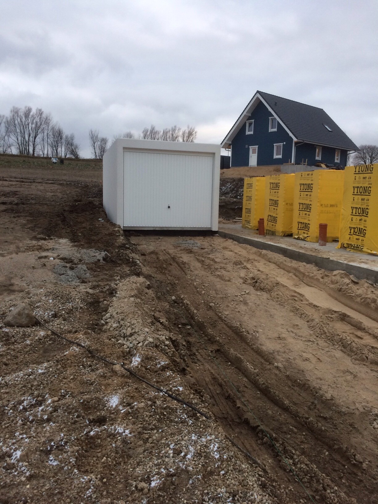

We are currently building with Wienerberger Poroton blocks (T8). According to the planner and general contractor, the prefabricated garage will be placed directly against the house façade without applying plaster beforehand. They say that it is sufficient to properly waterproof the roof area between the garage and the house wall.
Is that really enough, or should the exterior wall also be plastered behind the garage?

flospeedy1 Mar 2017 13:23The prefabricated garage is plastered on all sides.
flospeedy schrieb:
The prefabricated garage is plastered on all sides... or what is commonly called that
Typically, precast concrete garages of the "prefabricated module" type (meaning the garage is delivered in one piece on a low-loader) have a surface texture that blends with plastered areas. This texture can be integrated into the wall itself or applied as a coating—however, it is not comparable to traditional plaster layers about as thick as a finger; the wall is more homogeneous in cross-section.
In the case of precast concrete panel garages (assembled on site from panels), the delivery usually arrives as a raw shell to be plastered on site (with the plaster applied and layered similarly to masonry). Precast concrete garages made from individual wall elements (the rear wall of single garages is typically one piece, with the longer sides consisting of one or two elements) are generally designed like their "prefabricated module" counterparts.
Bieber08152 Mar 2017 08:01@flospeedy, can you find out why your site manager considers plastering the wall to be incorrect? Incorrect in the sense of not permitted, not unnecessary.
