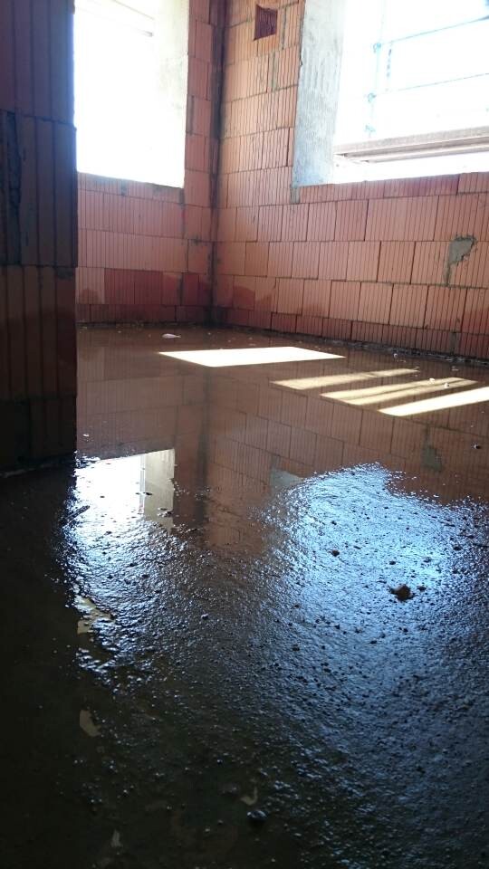

During the final phase of the shell construction, it rained repeatedly, and several rooms have or had 1-2cm (0.4-0.8 inches) of standing water.

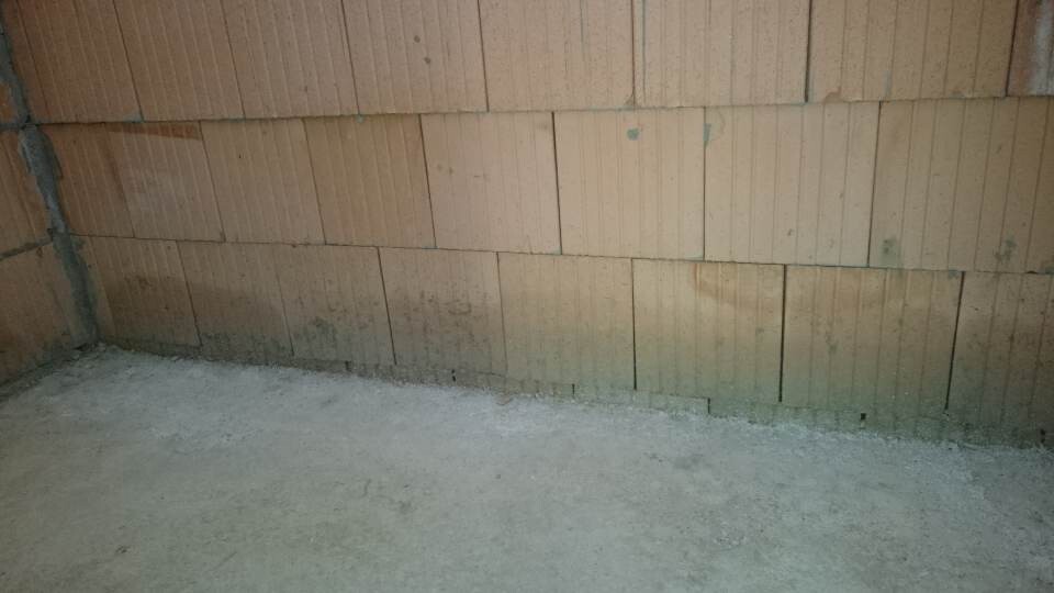

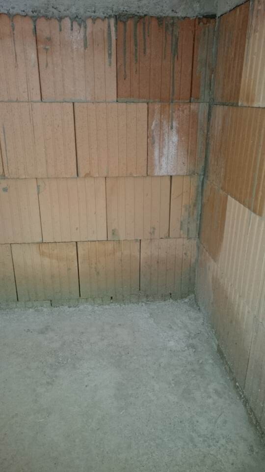

Some of the walls (Poroton masonry) are also damp. Perhaps water has entered the cavities of the bricks.
Will all this dry out on its own? Interior plastering is planned in about 3 weeks, and the screed in about 6 weeks.
I have also taken some photos.

toxicmolotof8 Aug 2016 13:23A construction dehumidifier only makes sense once the windows and doors are installed.
For my flowing screed, I used 6m³ (about 213 cubic feet) of water... that brings a significant amount of moisture into the house.
It takes 2 to 5 years for it all to dry out completely.
Residual moisture remains in the wall plaster, screed, and foundation slab.
I’m also not a fan of drying devices (high electricity costs) and a "move-in date 4 months after the foundation slab."
I’d rather leave it standing a bit longer (without insulation, of course).
Sebastian799 Aug 2016 09:17I don’t see any real water damage here, so I wouldn’t worry about it. Still, it’s a good idea to check with the trades involved to see if they are okay with it and consider it acceptable.
