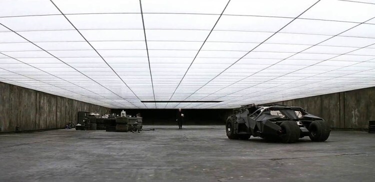

Dear forum members,
I am new here and hope I am posting in the right section.
I am planning a new (concrete) garage and would like to create something as impressive and elegant as possible. I imagine a dark poured asphalt floor, painted walls, and especially a large-scale yet energy-efficient ceiling lighting (possibly recessed into the concrete ceiling). My example – which always makes everyone laugh when I mention it – is the Batman garage from The Dark Knight.
Of course, this is probably just a bit of fun and I am not an expert in lighting.
My specific questions are:
a.) Is there an affordable and cost-effective way to achieve something like this? The garage measures 5 x 5.5 meters (16.5 x 18 feet).
b.) Would such lighting typically be installed as a suspended ceiling or embedded directly into the concrete ceiling?
c.) Are there any clever solutions or ideas to implement this without using square LED lights (like those I have found on Amazon or other sites)?
Thank you very much for your help and advice.

Build the garage 20cm (8 inches) higher. You should attach LED light strips in the desired color to the garage ceiling. Then lower the ceiling by 15cm (6 inches), using acrylic glass as the ceiling material. Use white transparent acrylic glass. That way, you get the effect. It’s actually quite easy. You can do it yourself with some skill and a little know-how. That way, it won’t be expensive.

And if it should be cheaper and more replaceable, use LED tubes instead of LED light strips. Or simply fluorescent tubes, which are even more affordable than LED.
