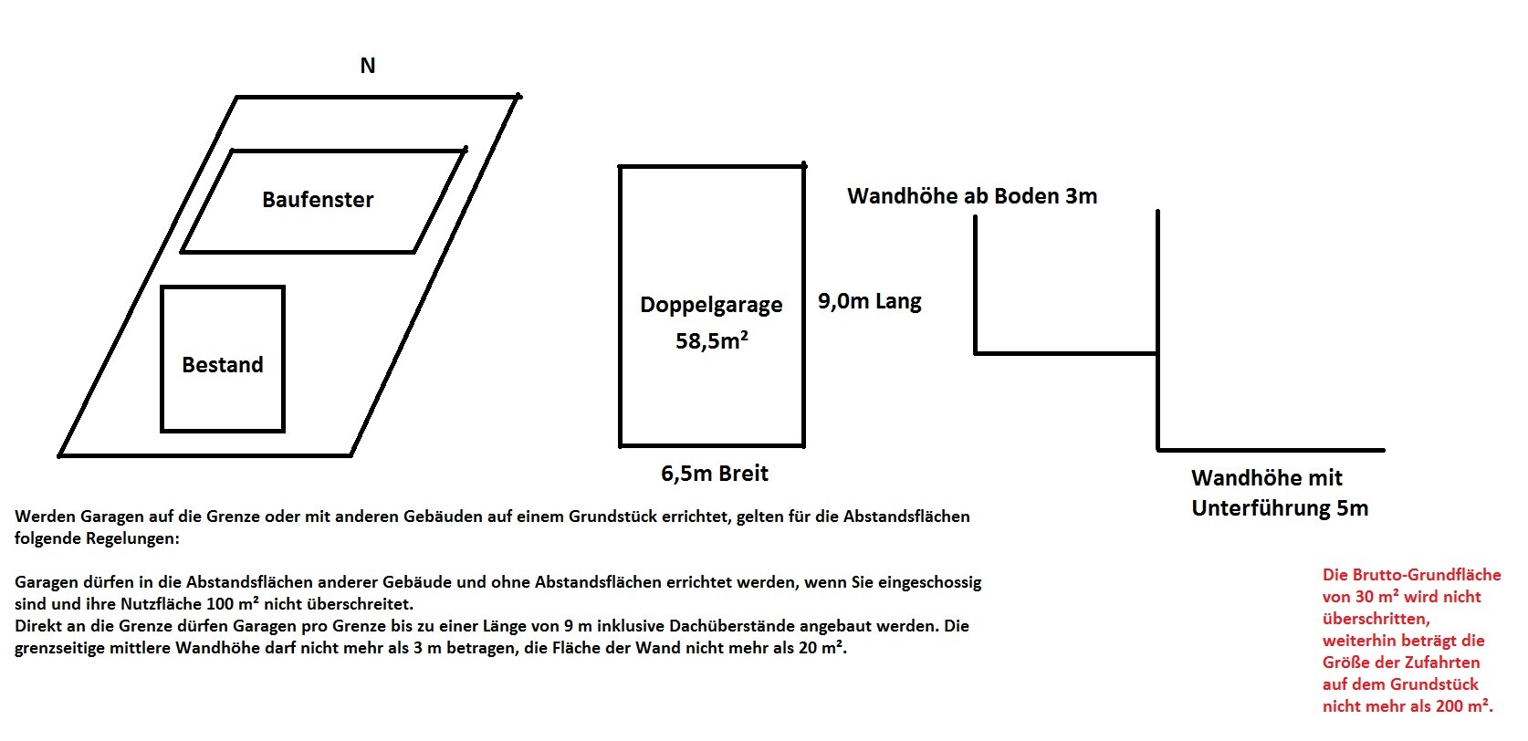

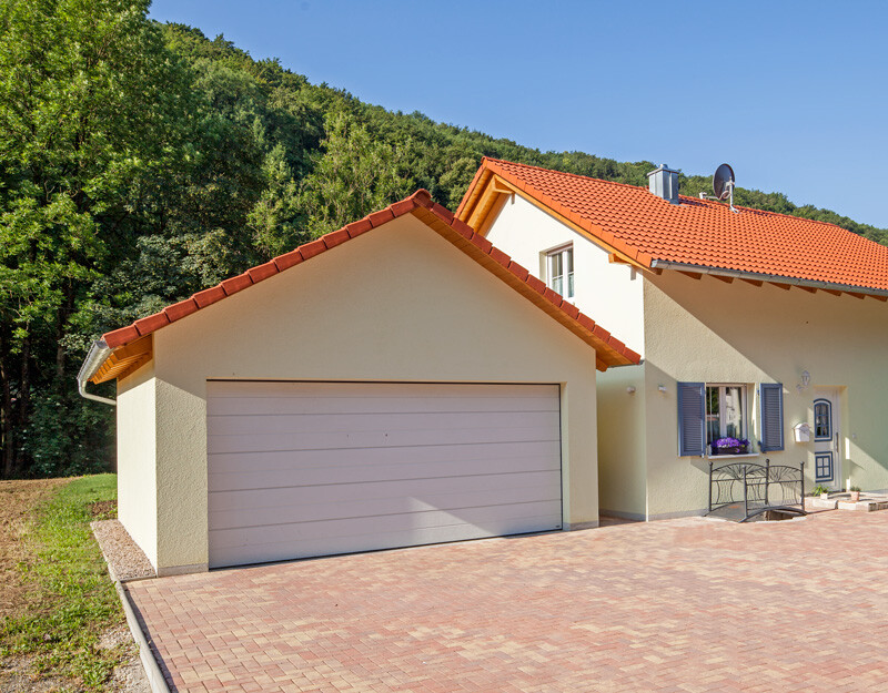

What concerns me more is the garage. Please look at the picture for reference. I have already talked to an architect, but somehow he explained things inadequately (or rather, in a way that was unclear to me). Maybe someone here can provide insights.
3. It’s about building on the boundary line, which is permitted if certain conditions are met.
The architect gave me these conditions:
- Wall height: 3 m (10 feet)
- Total length: 15 m (49 feet), regardless of the number of garages built there
- Maximum wall area facing the neighbor to preserve views: 25 m² (270 sq ft). This refers to the wall area extending along the boundary line to the neighbor.
On the internet, I found the following guidelines for Hesse:
However, this seems contradictory to me regarding the gross floor area in connection with:
When garages are built on the boundary or together with other buildings on one property, the following rules apply to clearance distances:
The terms gross floor area, usable area, and wall area (20 m²) confuse me. How and where do these apply? Where exactly is what allowed? This isn’t very clear to me yet.
I would like to build two garages. One single garage with 3 m (10 feet) distance from the neighbor, no boundary construction on the left, measuring 3 m (10 feet) wide and 4 m (13 feet) long.
The second garage would face the driveway but leave enough space for turning and access (a double garage), 6.5 m (21 feet) wide and 9 m (30 feet) long, right on the boundary line.
4. For boundary construction, does the garage need to be built along the entire boundary line, or is it enough if the start or part of it touches the boundary? For reasons of aesthetics, I’d like the garage to be rectangular, not triangular or oddly shaped.
5. First question: The wall height. I’d like to install a car lift in the garage, hence the need for more space at the back. Is it allowed to build the rear part of the garage lowered, like a basement, and drive in like a parking garage? This would give me enough height for the car lift.
Second option: Like in the picture, simply putting a roof (a pitched roof) with an empty space underneath would suffice to drive the car on without hitting anything. But I would need to know if this fits within the 3 m (10 ft) wall height limit.
Third option: My personal current favorite, but maybe a bit dramatic. As shown in the picture, a terrace directly adjacent to the house at the first floor level. The advantage is that you get nice midday sun if desired. Since there’s a 3 m (10 ft) distance to the neighbor (calculated from the 6.5 m (21 ft) wide garage, the terrace would end at around 3.5 m (11.5 feet)), I would convert that area into a terrace. Because the garage is quite long, I could also place a kind of roof over the back part of the garage at the same height as the terrace, with a sliding gate, for example. But not the typical top-to-bottom style, rather left to right. That way I could create a kind of opening to raise the car freely for work inside.
Which option do you think the building authority would be most likely to approve? Or if you have alternatives, please feel free to suggest them. The garage is for private use only; I do not intend to operate any commercial business there.
- The gross floor area of 30 m² (320 sq ft) must not be exceeded, and the size of accessways on the property must not exceed 200 m² (2150 sq ft).
- Garages may be built within the clearance zones of other buildings and without clearance zones if they are single-story and their usable area does not exceed 100 m² (1075 sq ft).
- Garages may be attached directly to the boundary line up to a length of 9 m (30 feet), including roof overhangs. The average wall height on the boundary side must not exceed 3 m (10 feet), and the wall area must not exceed 20 m² (215 sq ft).
