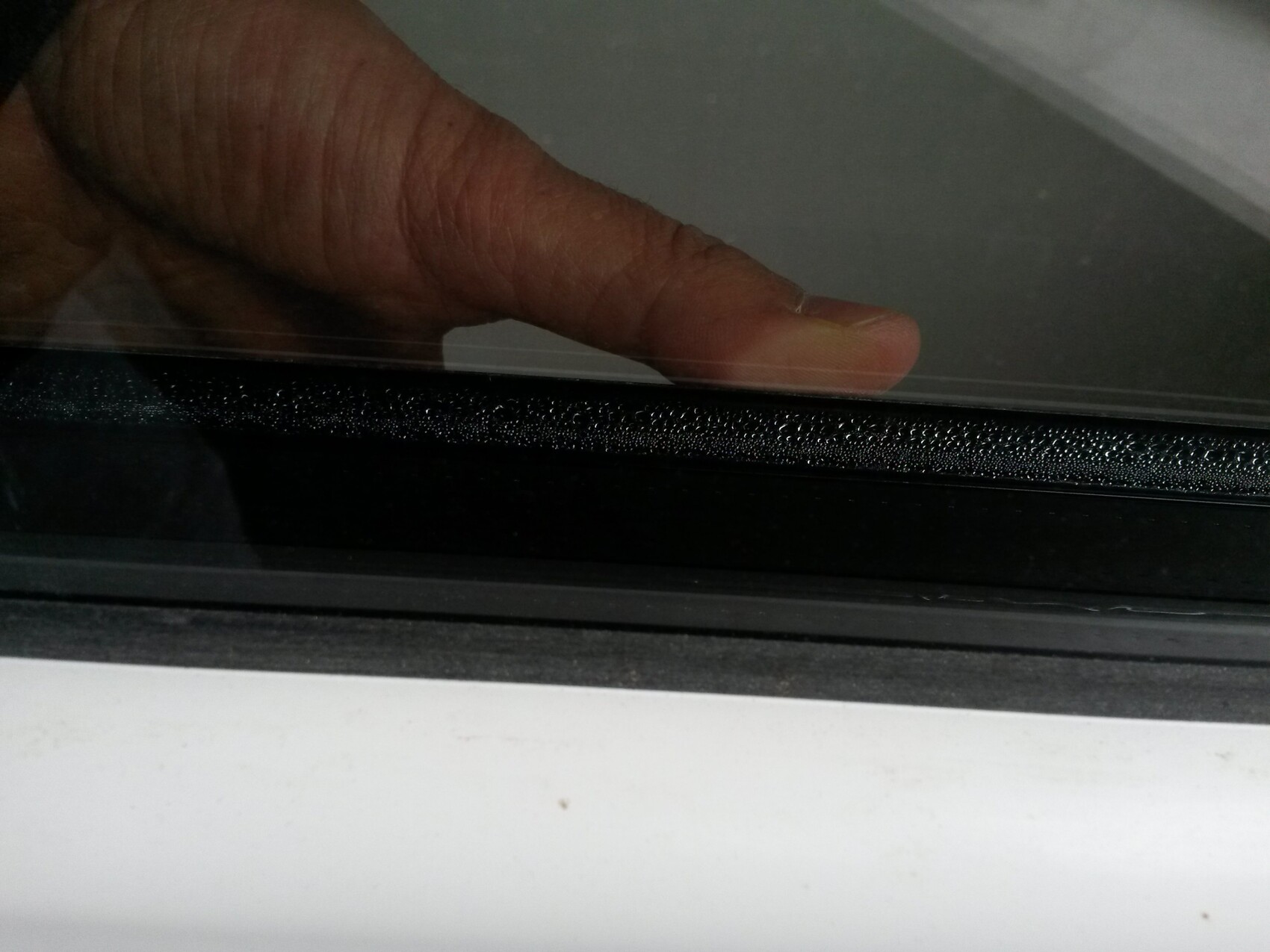

I have the following problem:
In our single-family house, which is currently under construction, the drying phase ended over the weekend. Now it is time for painting and tiling work.
While ventilating, I noticed that many windows have water droplets between the panes. The droplets are mostly located at the bottom of the inner pane’s seal but between the panes, meaning I cannot wipe the water away.
What could be the reason for this? Is this a defect that I should discuss and report?
Thank you in advance.
P.S. The windows have triple glazing and warm edge spacers.

Nordlys
17 May 2018 14:39
Yes. The seals are not okay. The windows will become fogged. They need to be replaced.
Paulus16
17 May 2018 20:17
What needs to be replaced, the seals or the windows?
Nordlys
17 May 2018 20:22
The panes.
Alex85
18 May 2018 18:16
Water means that outdoor/indoor air has penetrated. This, in turn, means the gas filling between the panes is lost, reducing the insulation performance.
18 May 2018 23:42
Please submit any defect complaints in proper printed form by mail (registered letter) with a deadline to ensure your protection later on!
Email is not sufficient in such cases.
