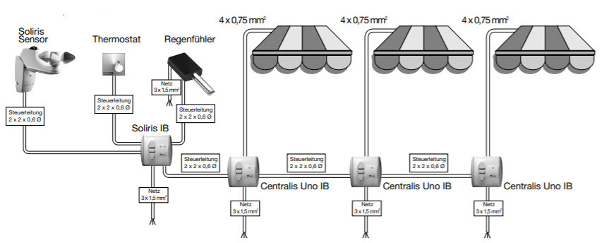

AllThumbs16 Apr 2021 13:51The main issue seems to be that the Tahoma Box only supports wireless protocols, while you have a bus-based, wired system.
The operation is actually illustrated quite well in the two images below. Each switch for an individual roller shutter initially controls only that specific shutter. The individual switches are connected via the bus line to the central switch. This allows the central switch to command the switch to operate the roller shutter without manual activation.
I haven’t quickly found any external system that can be connected to the IB bus. This seems to me to be a very niche solution from Somfy?
