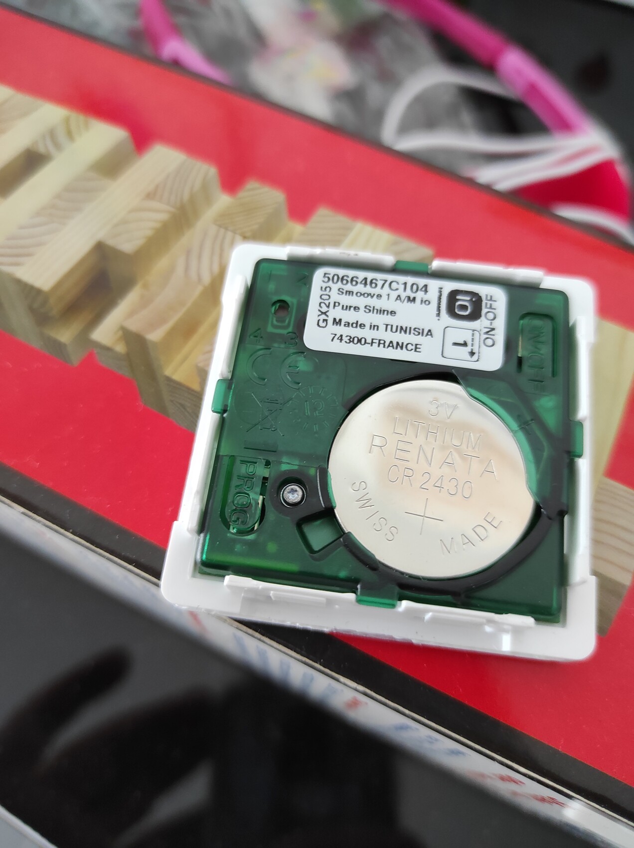

You’ll find the Prog button at the back.tomtom79 schrieb:
It’s a shame the Somfy forum no longer exists.
[ATTACH alt="IMG_20210414_141338.jpg"]60150[/ATTACH]As I mentioned, I don’t have a battery... mine looks different. What’s shown in your photo should be a radio switch, right?
We have everything hardwired...
