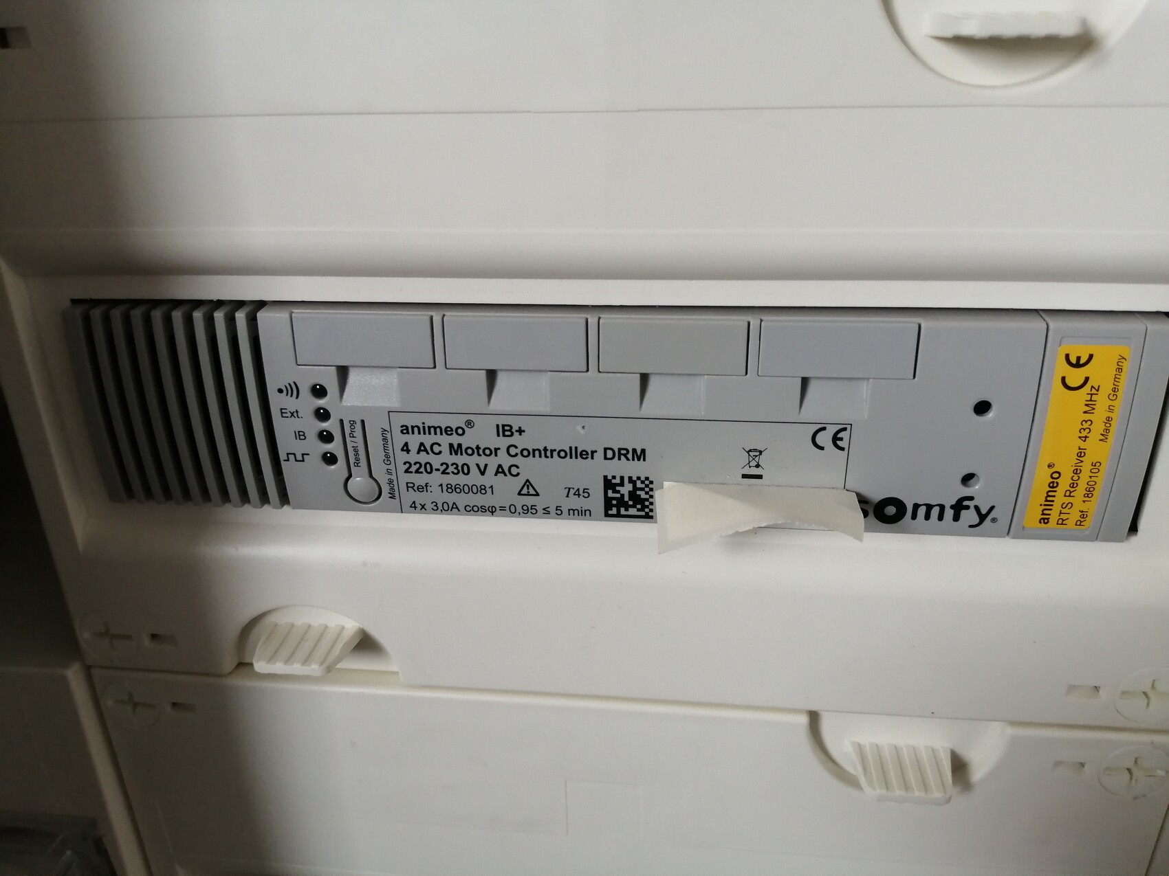

Thank you all, @AllThumbs has summarized it better than I have managed to describe over the last three pages. However, I only realized during my YouTube research that I don’t have an IO system; everything is without wireless.
What exactly do you mean by setup, @Strahleman? I have already configured the push buttons, and in addition, I have the Tahoma box and the x4 controller in the fuse box:
In addition, and this concerns me the most, I have this unused component x4:
tomtom79 schrieb:
But the actuators are both bus and wireless, right?Unfortunately, I don’t know... :/
