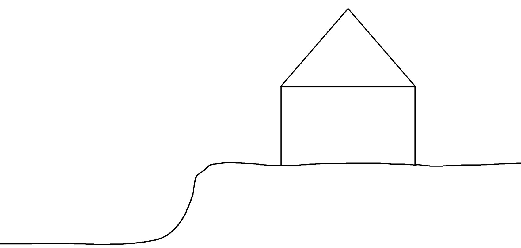

we are currently planning the preparation for the foundation slab with our earthworks contractor. Now we also need to decide how to retain the slope behind the house, which drops about 185cm (73 inches).
The setup (which can be seen quite well in the "slope idea" picture) is currently planned as follows: street/sidewalk/5 meters (16 feet) front yard, approximately 11 meters (36 feet) house, 4 meters (13 feet) terrace, and then we have about 10 meters (33 feet) left if we were to retain the whole area directly with L-shaped retaining blocks. These are quite hefty blocks, and 2-meter (6.5 feet) tall L-blocks are apparently very expensive. Including labor and concrete pouring, for the 15 meters (49 feet) wide area, the cost would be around €11,000.
Now the question is, what other options do we have?
Thanks for your help 🙂
- Letting the slope gently taper off would certainly be the cheapest option, but we would probably lose a lot of usable garden space. I don’t know how steep I can make this slope so that the terrace remains stable on it.
- Use L-shaped retaining blocks but decorate the front with a natural stone raised bed, so we wouldn’t have a two-meter (6.5 feet) concrete wall visible? That would certainly mean additional costs, so €11,000 plus the cost of the raised bed?
- Dry stone wall (maybe like in the cross-section double wall idea)? I have read different opinions about this; some say dry stone walls over 150cm (59 inches) might no longer be reliably load-bearing or cost-effective, while others suggest concreting this structure. However, I couldn’t find any pricing information on that. Maybe someone here has experience with this.
- Gabions or other options? The classic "flower stones" look too outdated for us, and gabions aren’t exactly the most attractive option either, but possibly if planted with stone plants, they might still be an option?

Our main concern is to explore options. Of course, we would prefer not to spend a huge amount of money on an unnecessary slope if that money could almost have covered a basement instead.
What would be your suggestion or advice on how to approach this without "damaging the building plot"?
In the end, most properties on the street are similar—some have been built with basements, others have terraces on stilts. We are open to any option. 🙂
