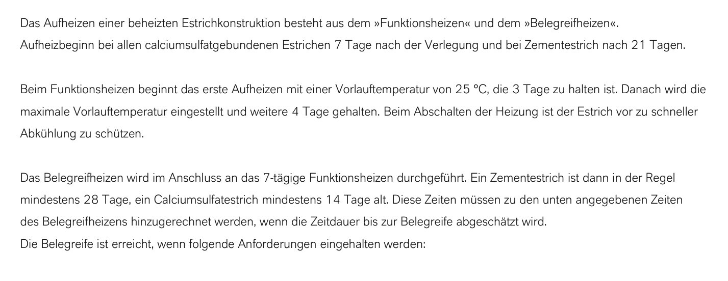

1. Initially, a functional heating phase is carried out. According to DIN standards, this tests the correct operation of the heating system with screed (including thermal expansion, etc.), ensuring that everything works properly during normal use. This also provides proof for the heating installer that the system was correctly commissioned and handed over. In the past, before heat pumps operated with supply temperatures as low as 30°C (86°F), most heating protocols specified 50-55°C (122-131°F) supply temperature because this matched the maximum temperature for underfloor heating. Today, it is often enough to heat only up to around 35°C (95°F) or the system’s maximum design temperature, which makes sense if higher temperatures are not used. You should check what is required in your case.
This process takes a few days.
2. After that, there is the drying heating phase, which drives out the last residual moisture from the nearly dry screed. This step is especially important for bonded floorings like parquet since the parquet adhesive acts almost like a moisture barrier. Tiles are less sensitive in this regard.
For clarification from online sources:
Textdokument über das Aufheizen einer beheizten Estrichkonstruktion und Belegreifeheizen.
The issue is that screed may appear dry after four weeks, but you can’t be certain that everything is fine. Even very small amounts of moisture can still cause serious damage. That’s why professionals always err on the safe side, whether it is strictly necessary or not.
In my own properties with heat pumps, I have only heated up to the supply temperature and then checked the moisture myself as described in point 2. For safety, I then ran the system for two more days, and that was sufficient – but of course, you do this at your own risk and only if you manage the work yourself.
Alternatively, you can simply pay a bit more at the start for fast-drying screed. This allows parquet installation after just one week, and all other trades can proceed as usual. With good coordination or if you do some work yourself, this can be a worthwhile investment, especially if it means moving in up to two months earlier.
