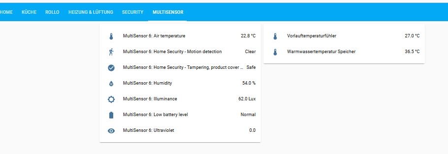

When building with KfW standards, individual room control is even mandatory, as far as I know. Just to mention: we have neither EER nor control valves (the plumber performed a hydraulic balancing). We built with a general contractor (KfW55) and decided to install this ourselves later (I was considering Homematic IP wireless room thermostats). Currently, we don’t use any EER. Neither the commissioned electrician nor the general contractor showed much interest.
edit: Homematic IP can also be well integrated into HomeAssistant
edit2: There is also a suitable interface for the ventilation system – in my case a Vaillant RecoVair. I have everything in HomeAssistant and can set up my automation there.
