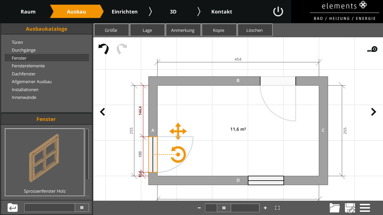

I am currently planning my new build and have reached the stage of designing the main bathroom. I need some ideas or help. Attached is the rough floor plan. The windows can still be moved without any problem, but unfortunately the door cannot. It is important that no installations are placed in the corner formed by walls C and D, as we want to keep the option open to add a door in the corner of wall C later on. Another requirement is a double sink, and I also really like the idea of a partition wall behind which the shower and toilet are located. Otherwise, I am open to suggestions. Thank you in advance 🙂

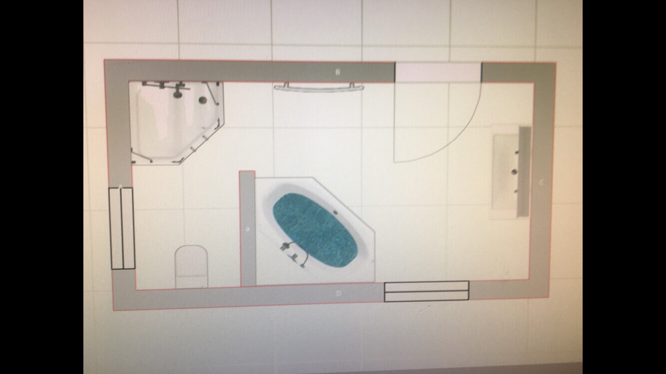

Thank you very much for the really great feedback. The bathtub should definitely be included. Both windows will be fitted with frosted glass for privacy. It doesn’t necessarily have to be a T-wall; I liked the idea in the design, but if my room is simply too narrow for it, it doesn’t have to be forced. I thought something like this would also be fine. The toilet should be somewhat separated in any case.
