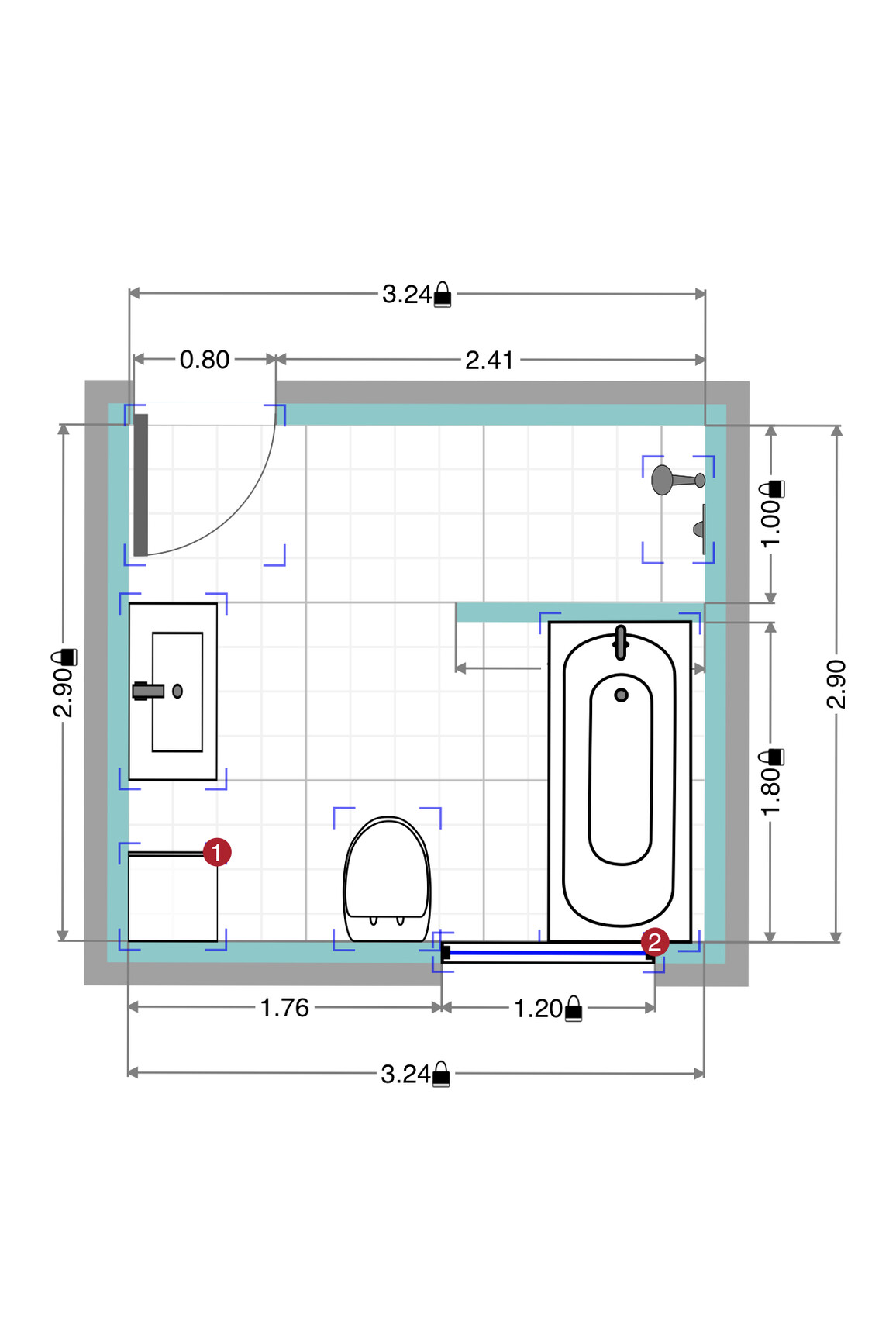

we are currently working on the floor plan and wondering if our 9 sqm (97 sq ft) will be sufficient for the end-terrace house. Our general contractor made a proposal (red walls), and I just created another version using an app (green walls).
In any case, we want a barrier-free shower without a door. The question now is which layout feels a bit more “open” and doesn’t make the room feel cramped.
Or should we widen the shower from 1.00 m (3 ft 3 in) to 1.20 m (4 ft), and include a bathtub that is only 1.60 m (5 ft 3 in) long? I planned the shower wall at 1.40 m (4 ft 7 in) to prevent too much water splashing outside.
What do you think?

goalkeeper schrieb:
Also, our general contractor planned the shower partition wall with only 10cm (4 inches) – probably made of drywall. Isn't it usually built with calcium silicate bricks? For us, it's 11.5cm (4.5 inches) aerated concrete. Then tiles are applied on top. The 10cm (4 inches) thickness—ask him what material he intends to use for that.

In a 1m (3.3 ft) shower, you won’t bump your elbows; that’s all you need. A shorter tub feels more cramped. I would build the shower wall with drywall; that also seems the easiest way to integrate shelves.
