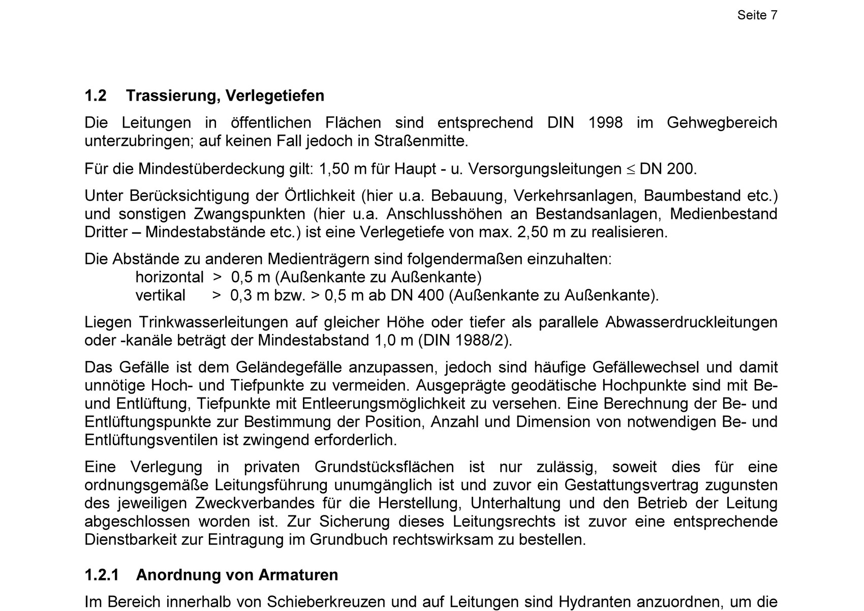

Barnhouse
11 Mar 2021 13:43
We received a similar statement from the local water supplier here in Brandenburg: the main drinking water and wastewater pipes must be separated by 1 meter (3 feet).

11 Mar 2021 13:45
Barnhouse schrieb:
We received a similar statement from the main water supplier here in Brandenburg, saying that the primary drinking water and wastewater pipes must be separated by 1 m (3.3 ft).
I also thought that they shouldn’t be placed close to each other.
Barnhouse
11 Mar 2021 13:47
Document page titled 1.2 Alignment, Installation Requirements, Text Paragraphs About Pipes and Clearances.
