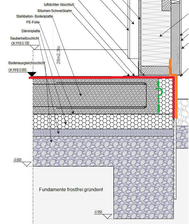

Hello everyone, (I know the forum cannot provide legally binding advice)
our house is built. Phew. An inspector came and criticized the base waterproofing of the slab (as shown in the photo in red and orange) – they said this violates DIN XYZ (13967?), and that the base waterproofing must run along the green line (directly on the concrete slab). However, they could not clarify whether we are in a grey area and it is still acceptable, or if it is definitely not allowed. The builder says that with our method, no rising groundwater will reach the wooden house – and that it is much cleaner and more practical to install this way.
Now my question: for a timber frame house (or any other type of house), where should the base waterproofing be installed: before or behind the insulation?
Could this cause us problems in the future?

Do you also have a prefabricated timber house? If so, I’m surprised that the construction company accepted it at all – usually, the finished wall panels already come with an overlapping EPDM membrane, which is then glued to the foundation slab on the side. That’s why their foundation slab acceptance requirements usually state that the insulation must be installed at least 15cm (6 inches) below the top edge of the foundation slab and should only be completed later.
Maybe they plan to trim the panels when the walls are erected?
