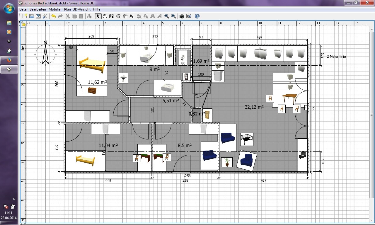

My girlfriend and I plan to convert the attic from my father-in-law. The stairs and connections are already in place. Insulation, windows, flooring, and walls still need to be done.
I’ve started working on a floor plan… actually 4-5, but this one seems to be the best.
The knee wall is planned at 1.20 meters (4 feet), with a roof pitch of 38 degrees, reaching 2 meters (6.5 feet) down from 1.10 meters (3.6 feet) height…
What do you think?
Is the benchmark of 1000 €/m² (93 USD/ft²) accurate for self-performed work? (Electrical, walls, laminate flooring, painting)
If you have this planned professionally, roughly how much would it cost?
A lot of questions and requests...
Thanks in advance
Butzi

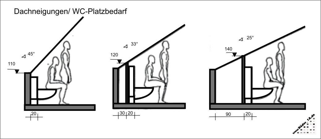

Your toilet is at 1.15 m (3 ft 9 in) height? Ouch!
You will need to build encasements all around the bathroom for the bathtub and the toilet.

Yes, I just saw that too.
It's becoming increasingly difficult to get a nice, flat surface....
Schematic drawing: various roof pitches over WC space requirements including toilet.

Right, how is that supposed to work with the kitchen? So, wall cabinets are definitely out of the question...

Unfortunately, I don’t know how else to do it...
I only made a few minor adjustments...
The bathtub, toilet, and kitchen units have now been moved away from the wall.
There is now a corner bench in the kitchen, but I think this means the floor-to-ceiling window may no longer make sense.
Can someone roughly estimate how much it would cost to have something like this designed and approved?

Butzi23 Apr 2014 11:14
with a 2 meter (6 feet 7 inches) line

The distance between the kitchen worktop and the counter is clearly too small.
