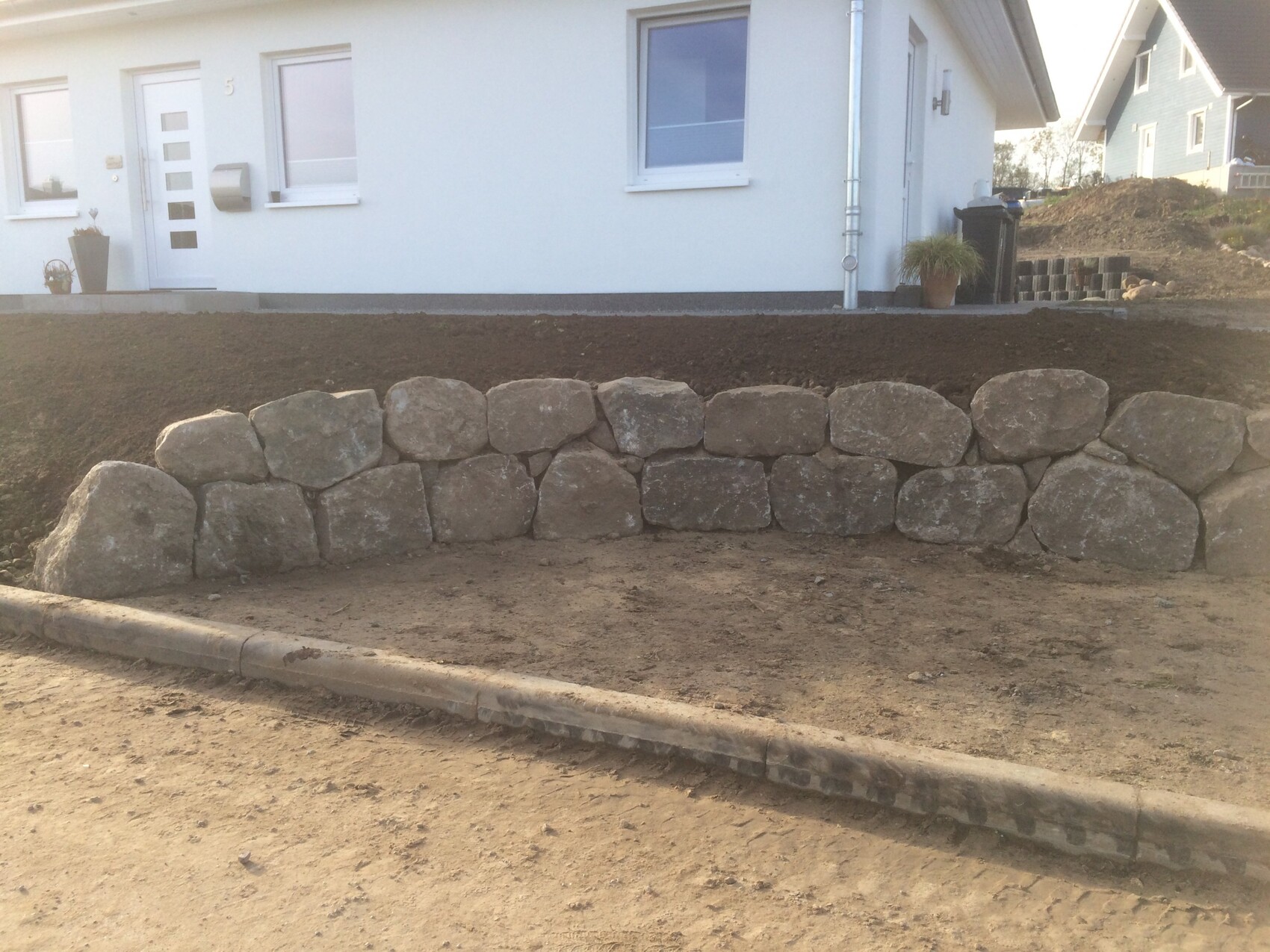

Nordlys
16 Jul 2018 12:20
A wall like that could work, but it costs money: $4,000 gross here. Karsten
White house facade with large stone wall as a retaining wall and unpaved foreground
11ant16 Jul 2018 14:33
Nordlys schrieb:
That kind of wall would work.
Is that actually your parking space?
