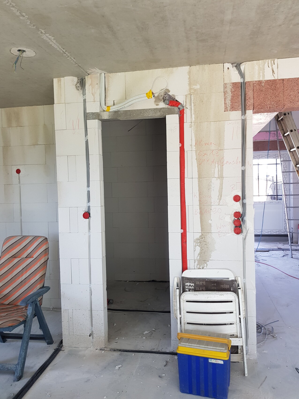

Pinky0301 schrieb:
Because what is missing?Something like this: (this is roughly what a wall looked like during our shell construction phase where a ductless mini-split unit was installed).
