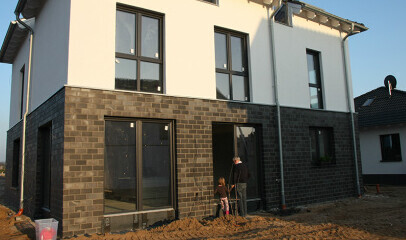

Then you could also consider building the house directly with a cavity wall system (for example, using sand-lime bricks). The lower part would be finished traditionally with “real” brick, and the upper part with external thermal insulation composite systems (ETICS).
For example, like this:
Two-story house in shell construction with dark brick facade and construction workers in the foreground
36.5 cm (14.4 inches) wall + ventilation cavity + brick wall = half a meter (about 20 inches) just for the appearance? That wastes a lot of land and generates many unnecessary costs.
