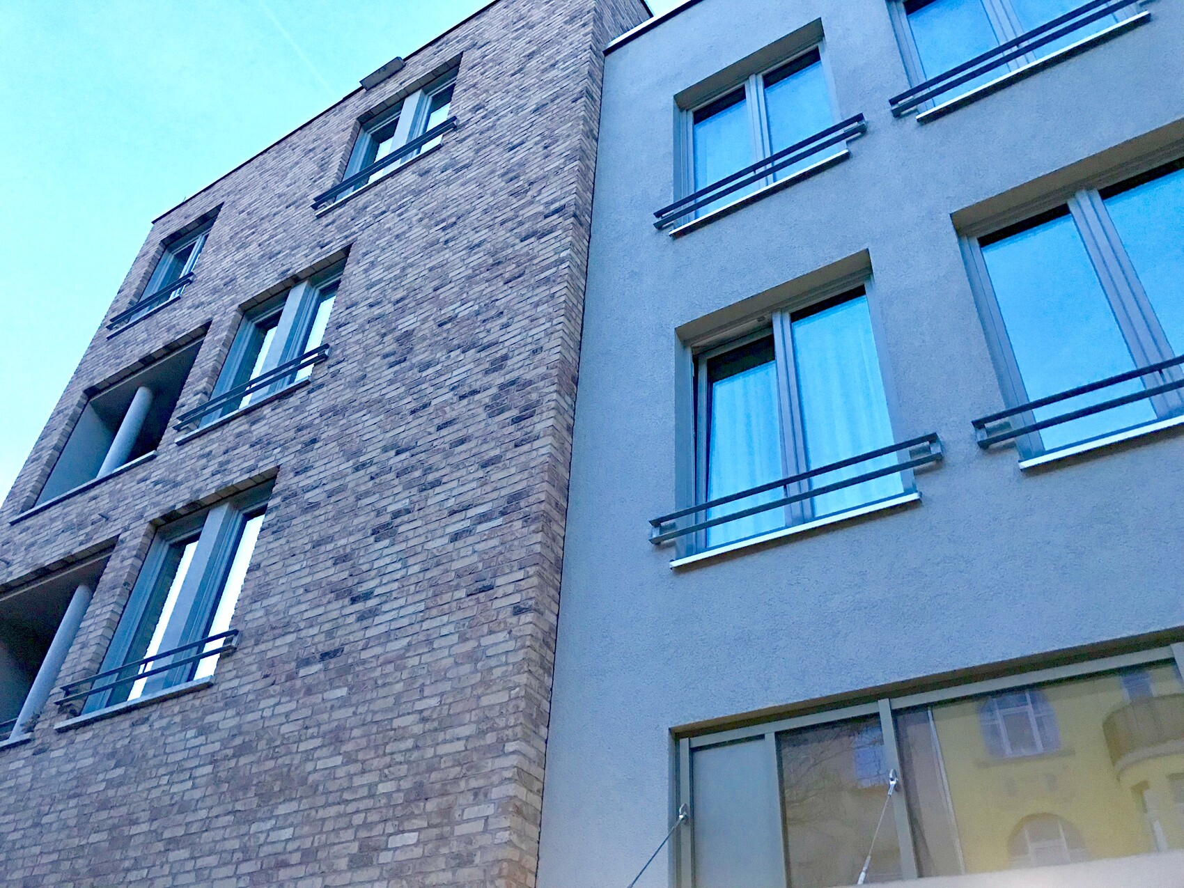

For aesthetic reasons, we are considering cladding the ground floor of our urban villa with brick slips. Should these be directly glued onto the masonry? The better option to me seems to be creating a ventilated facade. That means: aerated concrete, battens, and calcium silicate brick slips in NF format. Or does this not work?
And how do you create a visual separation from the plaster? – I imagine it might look a bit too subtle (?)
