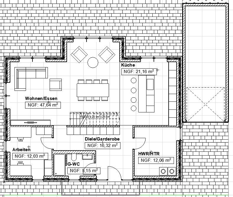

Regarding the layout itself: The ground floor is fine, but on the upper floor I would recommend removing the children’s bathroom and adding that space to the walk-in closet. Move the children’s bathroom to the current gallery area. Just make sure to carefully check the plumbing. Or as suggested: place the children’s bathroom between the children’s bedrooms. If a teenager will be moving out soon anyway, this child’s room can be designed smaller intentionally and later used by the other teenager as a bedroom.

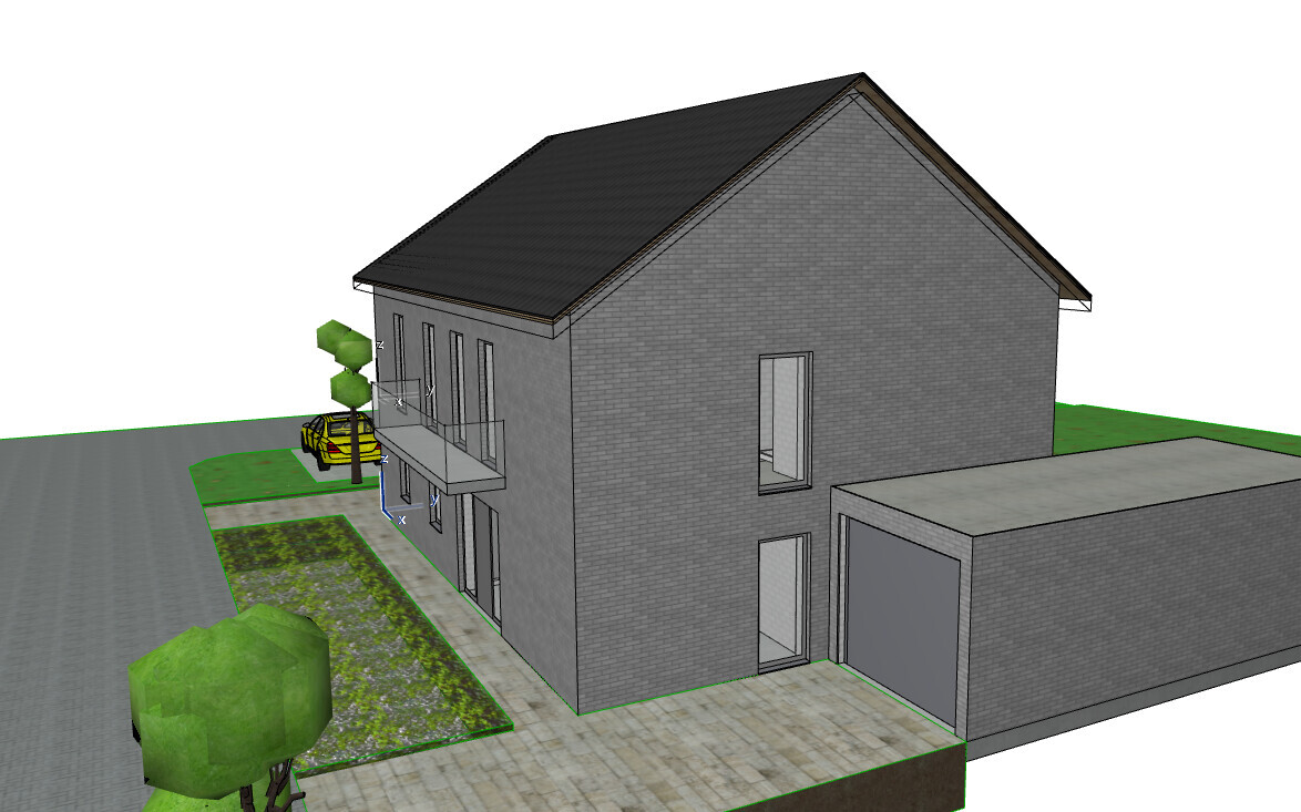

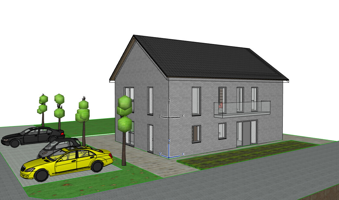

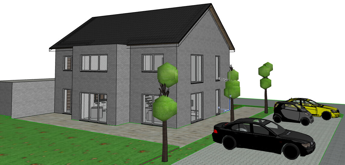

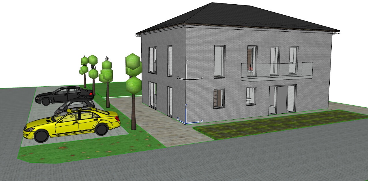

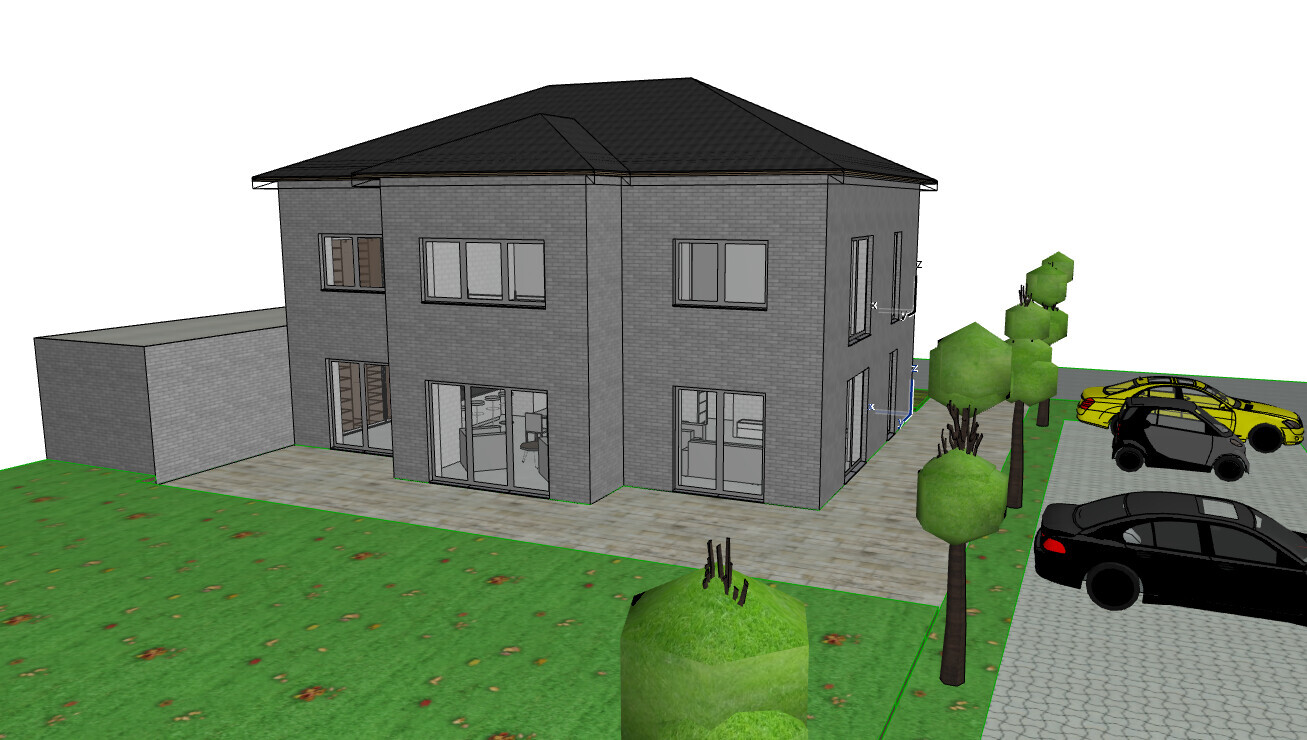

Which people are you referring to? Most of you are probably here out of boredom, so thanks to my posts, some might even find a purpose in their free time. :pI rarely speak up here. Actually only when I’m bored :p In other words, when I have nothing better to do. I often read here as a short break from work. You almost start to “know” the especially active forum members. Improving floor plans is kind of like doing crossword puzzles for me. I simply enjoy it. If I can help someone in the process, that really makes me happy. Sometimes the tone here annoys me so much that I lose interest and prefer to read a good book instead. It’s nice that there are occasionally posts that stand out positively to me in terms of netiquette, like #28.Overall, I have found this thread quite entertaining so far. I’m surprised that I’m apparently the only one here out of boredom and not out of altruism. 🙄 I hope you don’t start to stone me from now on—I’m happy to continue giving tips and my two cents on floor plans whenever I have boredom, I mean, time.
Of course, I also have an opinion on your floor plan. The open plan living area has a nice size and I would also like the kitchen. The entrance hall and wardrobe are also generously sized. A staircase in the living area is a matter of taste, but it could be nicely staged there, e.g., cantilevered or folding design. The bedroom with bathroom and dressing area works well. The kids’ bathroom is quite small and, above all, poorly located. I would put a utility room upstairs and leave only technical rooms and storage downstairs. The exterior views strike me as very dull. The symmetry with the bay window and the shed roof simply don’t fit together for me. A rooftop terrace would only make sense if it faced a different direction than the garden terrace. But I would probably remove the attic floor altogether without replacement.
Würfel* schrieb:
I find exterior views quite dull. The symmetry with the bay window combined with the shed roof doesn’t work for me at all. A roof terrace would only make sense if it faced a different direction than the garden terrace. But I would probably just remove the attic floor altogether. I tried to implement a few changes. Is it better now?
How much longer do you plan to keep organizing this "fashion show" of styles? A house should rather be a coherent design, not an addition of roof A, B, C, or D on an otherwise identical building structure.
I wouldn’t call it "better," but rather "(slightly) different." My impression is that your two main priorities in building are a strict facade and a straight, single-flight stairway, and that your design method roughly follows these steps:
1. Determine the size of the house
2. Design the building structure symmetrically with strict facades
3. Develop the floor plan layout based on the exterior
I recommend moving away from this kind of "reverse engineering" and developing the exterior from the interior instead.
