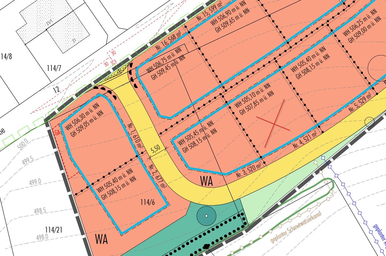

A.Dobler.8228 Aug 2025 15:02Site Development Plan
Plot size 525m² (5648 sq ft)
Slope No
Site coverage 170m² (1830 sq ft)
Floor area ratio 2
Edge development 9 meters (30 feet) garage
Number of parking spaces 2
Number of floors 2
Roof type Gable roof
Architectural style Modern
Orientation see plan
Maximum heights/limits see plan
Basement, floors without basement
Number of occupants, age 3 people: 2 adults, 1 child 11 years old

Ah, so we are talking about a real construction project, and the separation of the child’s room and the home office is mainly motivated by the desire to avoid having the rooms on too few levels. A teenager will probably appreciate living "a bit further away from everything." Where does the planner’s cost estimate come from in a DIY plan?
The plot shows a slope of about one meter (3 feet) from the street across the area of the house footprint. This means, according to the 11ant basement rule, an optional basement level is possible. In general, an amateur plan leads to about twenty percent more floor area and costs due to lack of experience (excluding any luxury square meters), so consulting an independent architect often more than pays off (which I generally recommend to separate the fun of DIY from the real responsibilities of being a homeowner). The previously mentioned flawed details have already been pointed out – I don’t need to add anything else here but will later share my likes (meaning roughly: "I would have said something similar, saving everyone from duplicate content").
