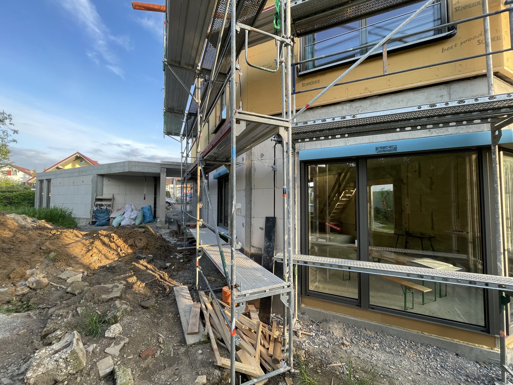

for us, the decision against aluminum in wood-aluminum windows was based not only on price but also on flexibility.
Other than one well-known local manufacturer, there were only full-aluminum profiles available from Eastern Europe. The aluminum color had to be the same inside and outside. Since we wanted quartz gray on the exterior and a lighter shade inside, this was a major factor.
Additionally, our subcontractors often only supply the Eastern profiles as just the basic window unit—no fall protection, insect screens, blinds, or other accessories. We wanted everything from one source, and in the Stuttgart area, there are only two larger Austrian manufacturers.
One was unaffordable (for us), so the choice was quite clear for wood-aluminum from Austria. I’m also a fan of full-aluminum when it fits the house design and you can effectively use the strengths of this profile system.
However, I would not mix the two.
It is noticeable.
Attached are impressions of our wood-aluminum windows in the living room. We wouldn’t have liked the darker tone inside here.
Unfinished living room shell construction: ladder in front of windows, dusty floors, visible cables.
Construction site at residential building: scaffolding around yellow facade, large window fronts, and building materials.
Gerddieter
1 Jun 2023 20:44
@Malunga - looks really good!!!
I also considered this Austrian manufacturer – but the general contractor and their window installer were completely against it, so there was no point insisting.
Both aluminum and wood-aluminum options are now from manufacturers or profile suppliers that I can comfortably work with.
Thanks for sharing your impressions on the topic!
