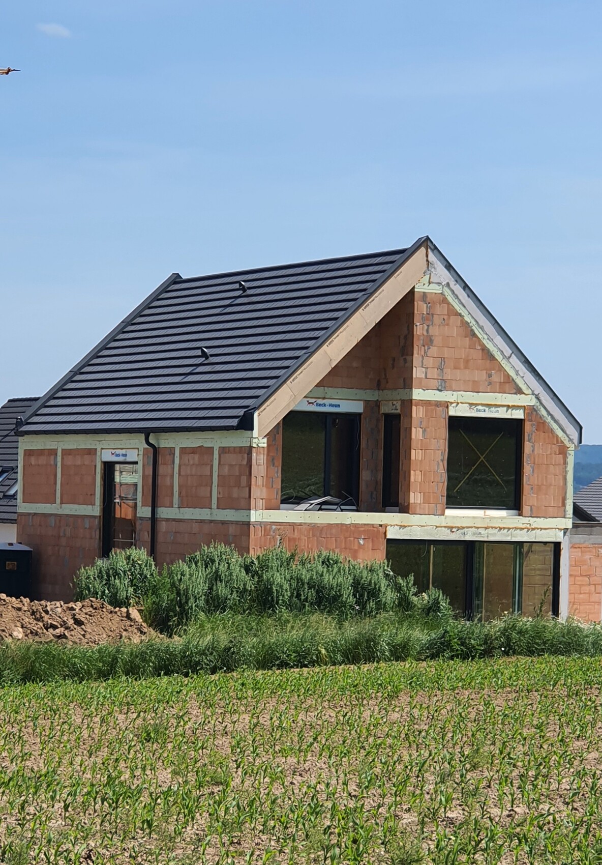

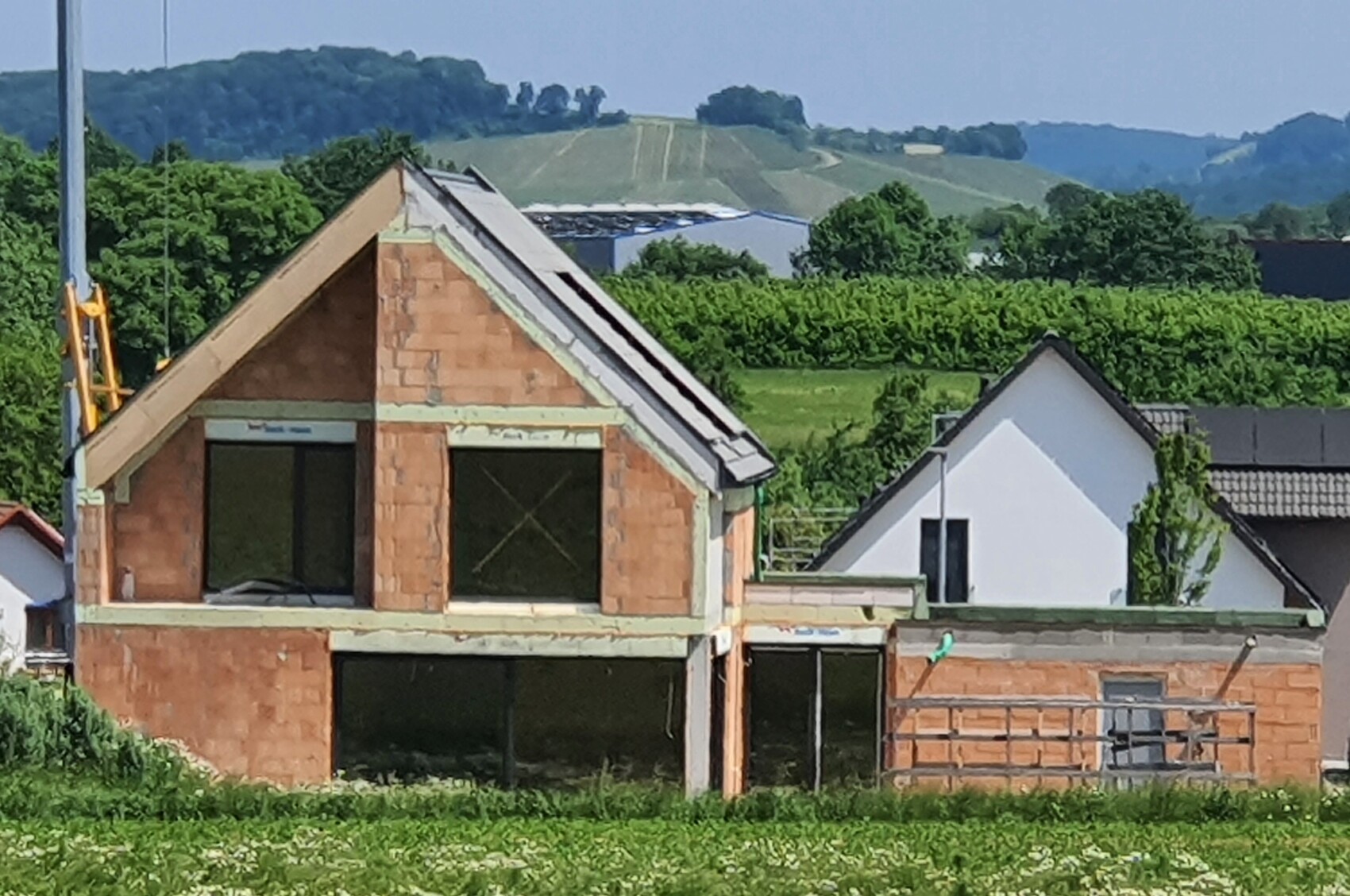

Josko would have been the alternative A; the offer was 105,000 eurosYes... that is unaffordable...I am currently on the construction site. I took two snapshots of the southwest facade 😉
Kati2022 schrieb:
Yes....that is priceless...
I am currently at the construction site. Took two snapshots of the southwest facade 😉Best bricks 😉Looks like the Rems-Murr district…
Heilbronn? Neckar region?
