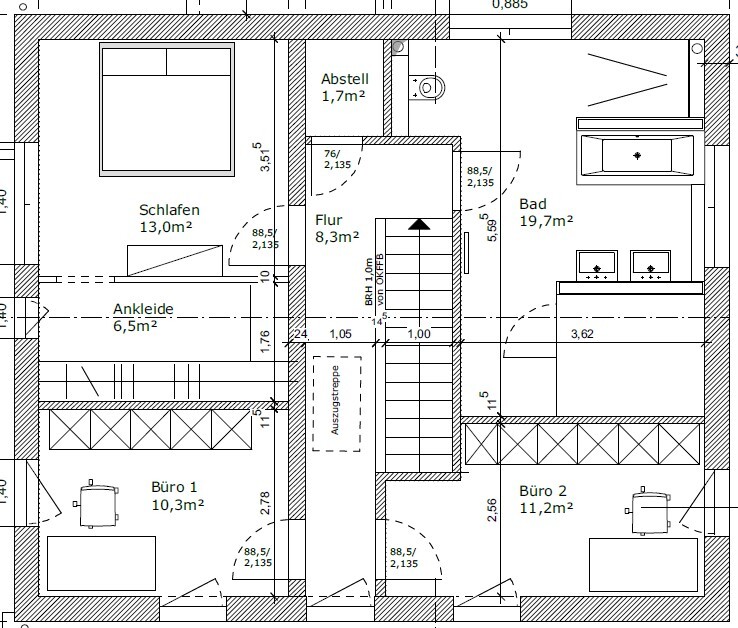

Elias_dee6 Aug 2022 16:10Hi everyone, I find this thread very interesting! I am currently in the process of requesting an air conditioning system for my new build and would like to keep my upper floor comfortably cool. Attached you will find my floor plan. I especially want to sleep in a cooler environment and generally keep the offices on the upper floor cool as well. So the idea is to have one indoor unit in the bedroom and another one positioned centrally in the hallway to help distribute the air.
For this, I would choose a 2.5 kW (or so) unit for the bedroom and a somewhat more powerful one for the hallway.
What do you think, would this work? And where would you place the two units in the bedroom and hallway respectively?
Thanks in advance!
Thanks in advance!
Elias_dee schrieb:
Hi everyone, I find this thread very interesting! I’m currently in the process of requesting quotes for an air conditioning system for our new build, and I would like the upper floor to be “comfortable.” Attached is my floor plan. I especially want to be able to sleep comfortably in cooler temperatures and keep the offices on the upper floor cool in general. That’s why I’m considering installing one indoor unit in the bedroom and another in a central spot in the hallway to help distribute the air.
For the bedroom, I’m thinking of a 2.5 kW (2,700 BTU) unit or something similar, and a slightly more powerful one in the hallway.
What do you think? Would this work? And where would you position the two units in the bedroom and hallway respectively?
Thanks in advance!I would only recommend a central air conditioning unit if you have a central ventilation system. Otherwise, there is likely too little air exchange between the rooms.
(At 200 m³/h (120 cfm) and assuming a building volume of 600 m³ (21,200 ft³), the air is completely exchanged every 3 hours.)
Ideally, an enthalpy heat exchanger should be installed at the ventilation system so that the incoming fresh air can absorb the humidity from the dehumidified exhaust air. This way, the incoming air enters the house with reduced temperature and humidity, which makes the cooling much more comfortable.
We plan to do it as described, with one unit each on the ground floor and the upper floor.

Elias_dee7 Aug 2022 10:49Crixton schrieb:
I would only install a central air conditioning system if you have a central ventilation system. Otherwise, there is probably too little air exchange between the rooms.
(With 200m3/h (about 118 cubic feet per minute) and an assumed building volume of 600m3 (21,188 cubic feet), the air is fully exchanged every 3 hours.)
Ideally, install an enthalpy heat exchanger at the ventilation system, so the incoming fresh air transfers humidity from the dehumidified exhaust air.
This means the incoming air enters the house already with reduced temperature and humidity, which makes the dehumidification by air conditioning especially comfortable.
We will do it as described, with one unit on the ground floor and another on the upper floor. Thank you for the advice. We have actually planned a central ventilation system. However, I had designed the air conditioning independently of that...
edit: Thanks also for the tip about the enthalpy heat exchanger! We have planned that as well, but only 1-2 years after moving in. I’ve often read that it is better not to use it at first, so that construction moisture can be removed more effectively...
Yes, these are two completely independent systems, and both make sense in today’s houses. If the budget allows, it is definitely worth installing either one or the other, or even both.
Of course, it would be ideal if both systems could work together rather than against each other.
