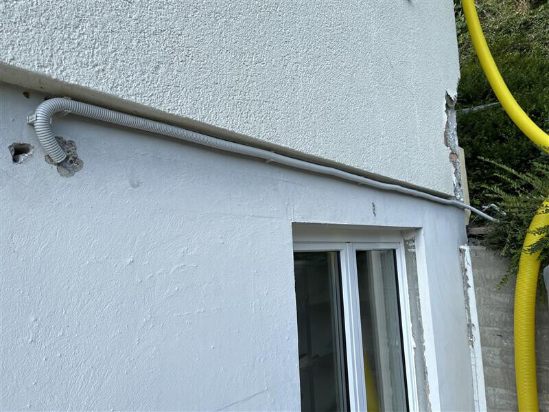

Hey @Mycraft, thanks for your support. I’ve learned a lot here and can somewhat follow the HVAC technician with my basic knowledge. In the end, he will decide which solution is best. One could also consider installing a conduit on the exterior wall surface in case access is needed later. I have a similar decision to make regarding my photovoltaic wiring. Of course, nothing should go wrong in 20-30 years, but if it does, opening up the insulation and cladding is very difficult.

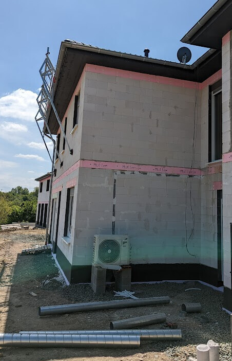

This is how it was connected in our case, in case it helps you:
What you see outside here is only the power cable. The cooling line goes directly through the wall and ends inside the living room. From there, it is distributed. We originally planned to place the air conditioner next to the heat pump (just outside the frame on the right), but in the end, the pipe length didn’t fit.

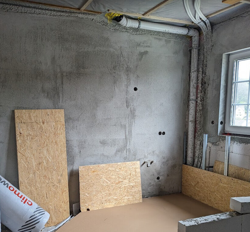

Here is an older photo of the interior view. These are all work-in-progress pictures; it’s all covered up now. The pipes run along under the suspended ceiling and continue through the ceiling to the upper floor (the bathroom is above there).
This is what the bathroom below looks like. The air conditioning pipes are the white ones, to the right of the drain pipe.
@paulch7
Everything can be installed flush with the wall. Usually, if at all, you only need access at the connection points. These are mostly located directly at the devices. The cables between them are in one continuous piece. Therefore, it is safe to embed them in the wall.
The pictures are very helpful. In your case, the wall was channeled. I would prefer to fix electrical and refrigeration pipes to the masonry using clamps before insulation. Is that possible, or does it have to be channeled? It’s an old building... the concrete tends to chip, and I only have a single 16cm (6.3 inch) wall layer, which I’m reluctant to channel because it still needs to support the exterior insulation system.
