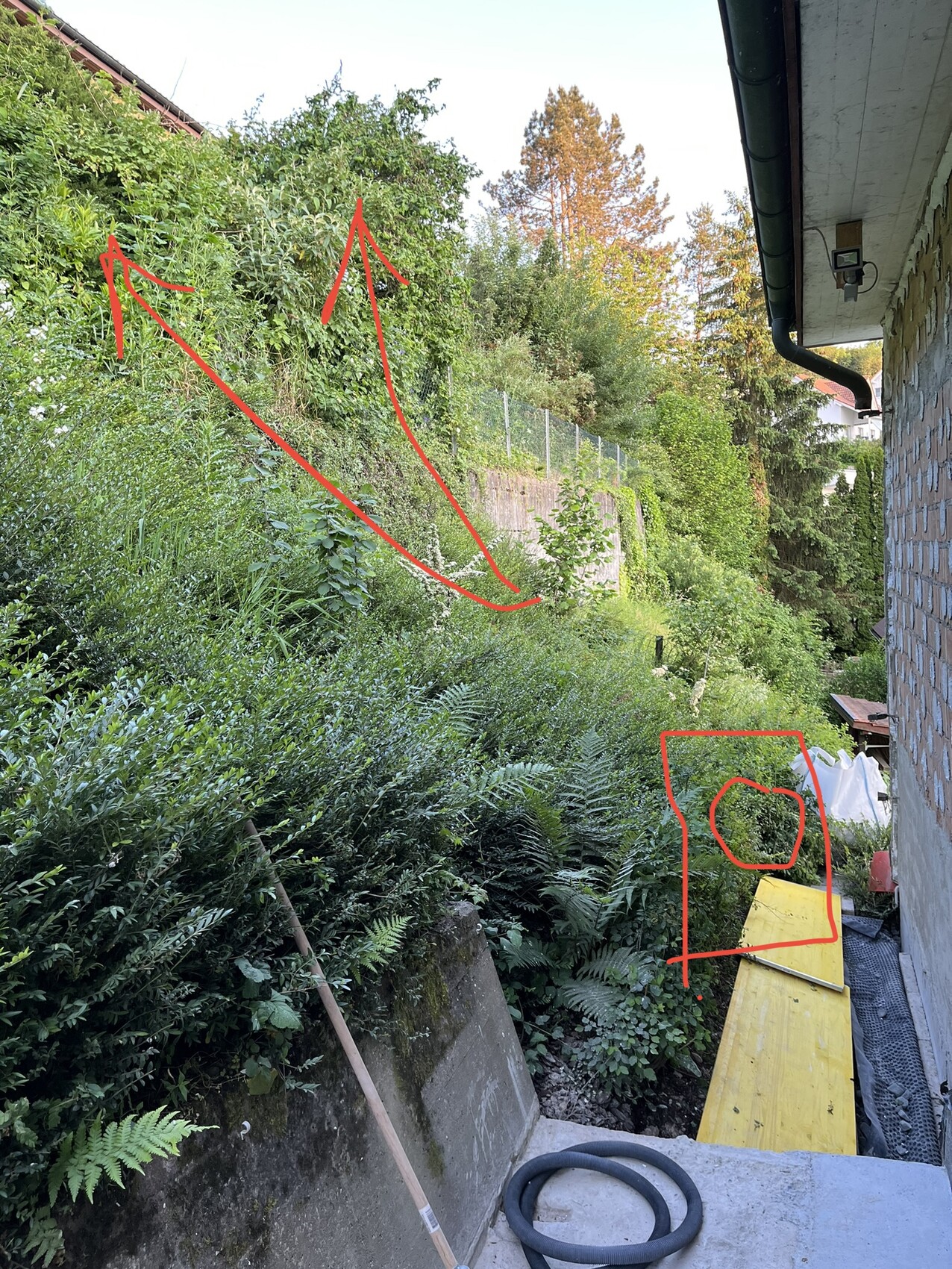

Thank you very much for the feedback. So far, Daikin is leading. Question regarding the positioning of the outdoor fan unit: the house is on a slope, will a lot of noise reach the neighbors above (red lines)? Is it possible to install with an extremely short refrigerant line—2 meters (6.5 feet)? The study is located directly behind the wall in front of the fan unit.

Thanks Mycraft. What do you think about Sarara Ururu? It’s really expensive and large, and the local distributor said they discontinued it because the cost-performance ratio wasn’t right. Daikin is expensive, there’s no denying that. You just have to weigh the options. There’s basically nothing wrong with TCL either.
I’m gathering some quotes first... My local city (or rather village) administration here in Switzerland requires a permit process, including signatures from all neighbors... Well, that’s something. Maybe I’ll also go ahead and plan the air-source heat pump at the same time.
paulch7 schrieb:
First quote for 1 Mitsubishi M-Series R32 MSZ- AP25VGK monosplit, including installation, over 4000, which I would have expected more from Daikin rather than Mitsubishi.For how many split units?That sounds rather reasonable given current conditions. Our first (Mitsubishi) quote for 3 split units was just over €5000 in 2020. For the current one from Remko (5 split units, of which 1 unit is being covered by the contractor), it’s just under €14,000.
We really waited for months here for an alternative offer (including Daikin, but also Mitsubishi), and our plumber couldn’t even source the units.
