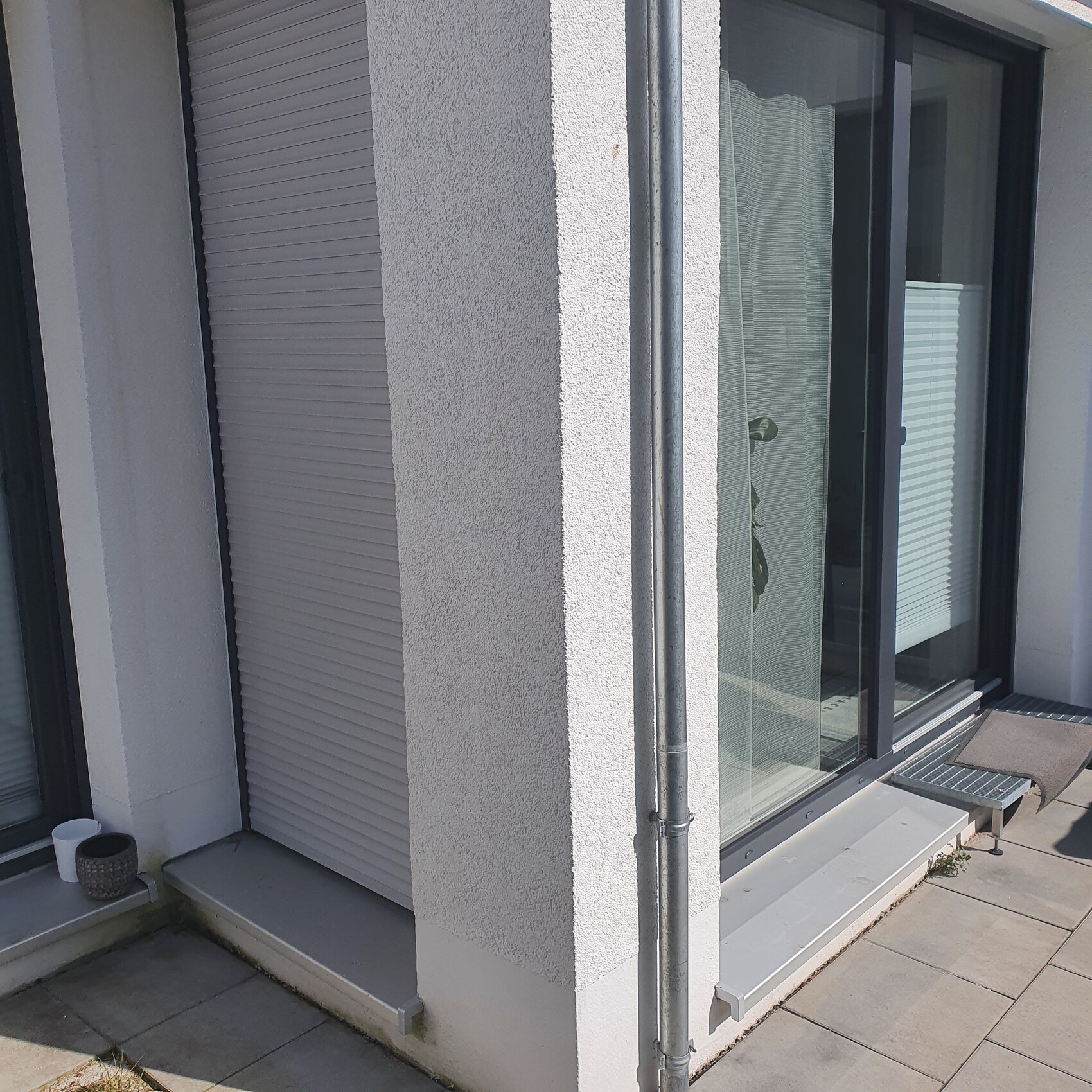

In our current apartment, the corner measures 46x47cm (18x19 inches) with external thermal insulation (ETICS). Since we are planning without that, the support column should be smaller, I think? Or does it not matter for the price whether the support is smaller or completely omitted? We would find it a pity to have a full meter of wall in the corner since it faces south and offers a nice view of a small mountain...
