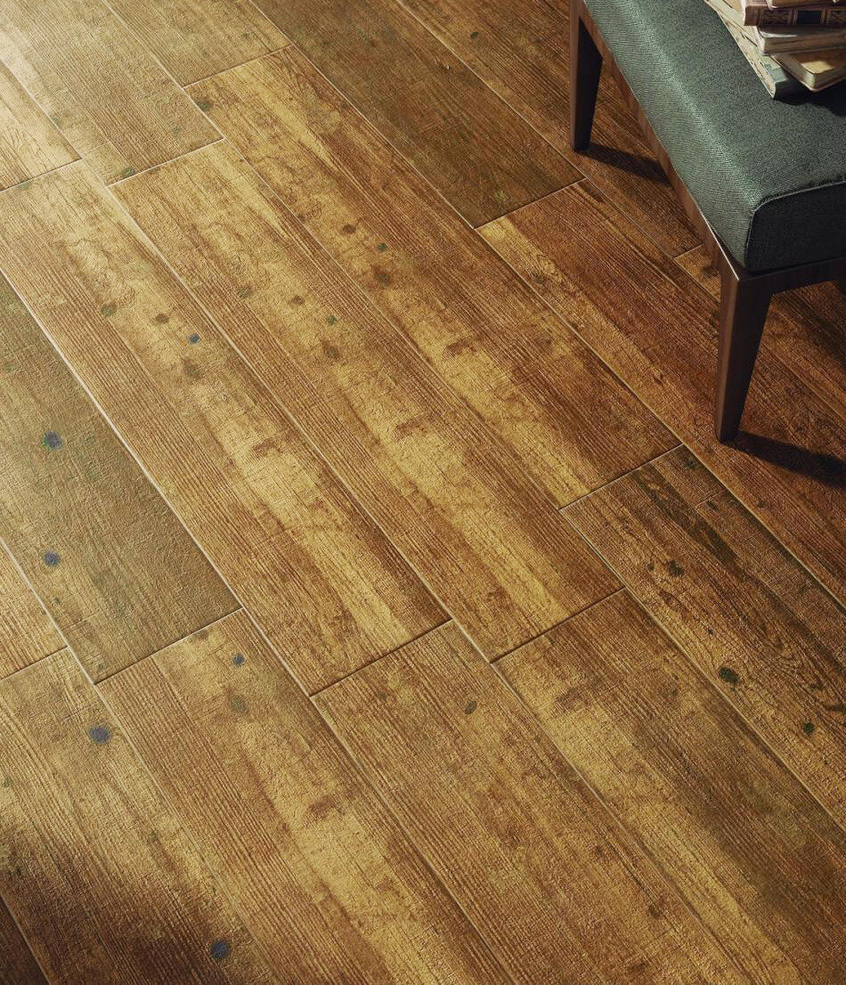

Tiles: durable, comfortable with underfloor heating, but have a “cool” appearance.
Have you ever considered wood-look tiles? For me, tiles combined with underfloor heating are the most durable and practical choice. I personally like the classic tile look mostly in bathrooms. However, there are really great wood-look tiles that also imitate the wood grain. This combines the advantages of parquet (warm appearance) with those of tiles (durability). The price is also not higher than good quality parquet.
Another advantage is that you can lay the same material throughout all rooms (bathroom, living area, kitchen, hallway) without changes in material, meaning no steps or transitions.
What do you think?

AllThumbs18 Apr 2021 09:18We are planning to install tiles with a mostly wood-look finish throughout the entire ground floor. "Mostly" because we will probably use a size of 120 x 30 cm (47 x 12 inches) and the look will not be as wood-like as in your example photo.
However, this choice doesn’t get much approval among our generation. It seems to be somewhat out of fashion. That said, we are not completely decided yet, partly due to the "concerns" mentioned in this thread.
