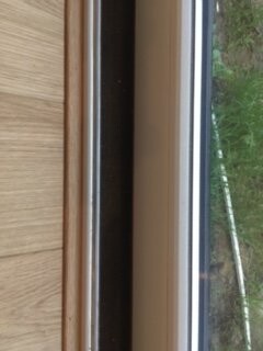

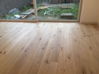

As promised, here are a few photos. The floor was oiled in place after installation.
The room is about 10m long (33 feet). A small oak strip was installed under the floor-to-ceiling windows because baseboards would have been too high.
I am definitely very satisfied and happy that it still smells like wood and oil. 🙂
Unfortunately, one photo is somehow upside down sideways. I can’t get it straight again. To see everything properly, you’ll have to rotate your screen. 😀

New wooden floor in the living room with a view outside through glass sliding doors.

Close-up of a wooden window frame with glass, view outside to green area.

The parquet itself doesn’t have a specific name. I supported the local individual installer who sources the wood from somewhere and therefore it doesn’t have any fancy names. It is "stabilized oak flooring on birch multiplex, 12mm (0.47 inch) thick, 4mm (0.16 inch) oak parquet, rustic," oiled with Osmo hardwax oil natural with a bit of white (I don’t know the exact white number right now).
There are countless parquet floors available.
If you want to oil instead of lacquer, I recommend making sure it is oiled only after installation. There are also pre-oiled planks available for purchase, but that is not as good.
Small height differences occur during installation that can still be sanded away if the parquet is not pretreated.
Additionally, you can choose any oil color you like, which can make the floor appear, for example, whiter, warmer, more natural, darker, or so.
Just visit a specialist retailer, preferably a smaller local company, not a big-box hardware store.
