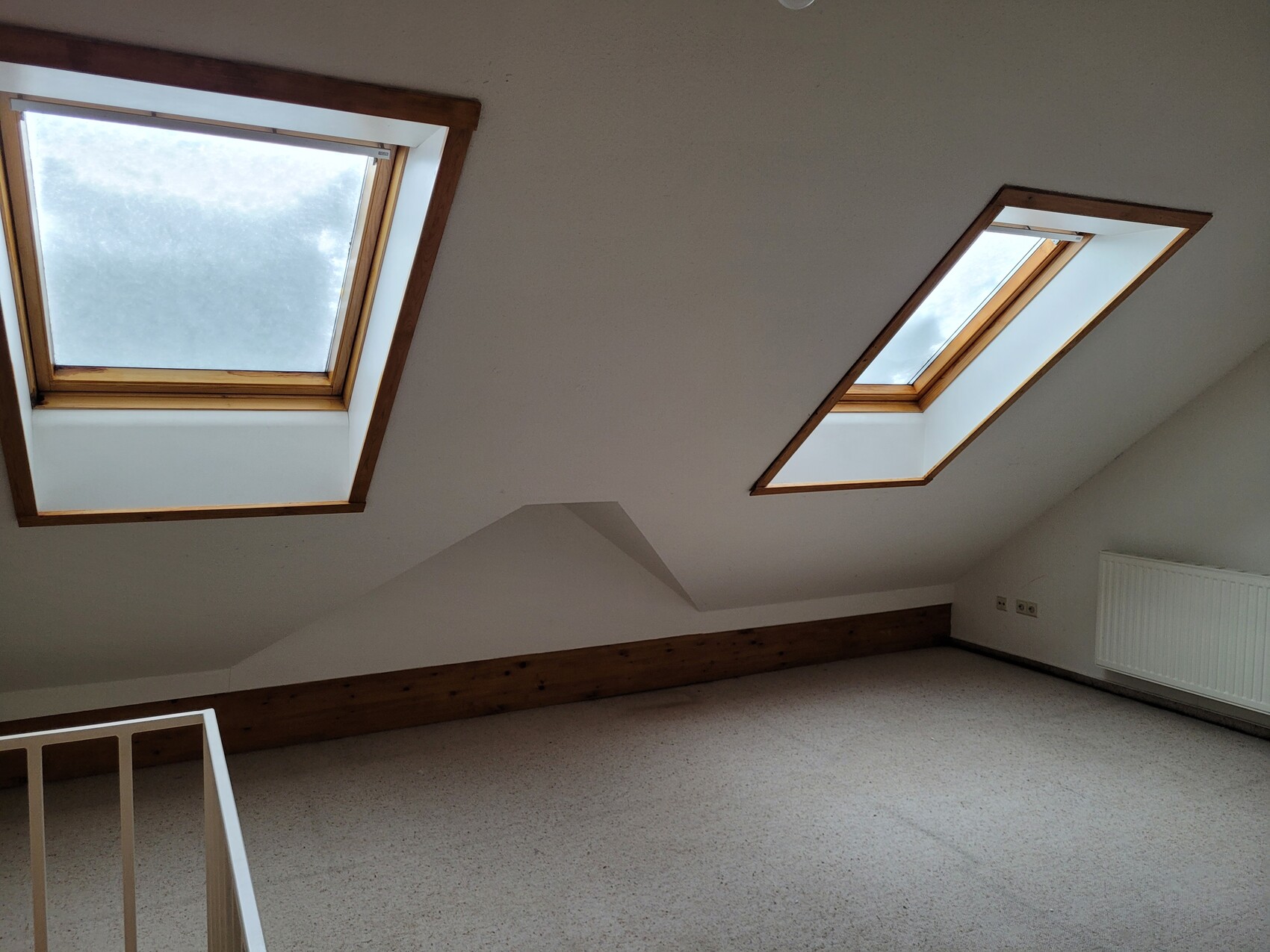

I raised this topic in another thread, but it seems more appropriate here. I wanted to get an idea of whether it’s feasible to install hardwood flooring over tiles (I wouldn’t do it myself, since I have no experience with this) or if the tiles need to be removed first. I have read that it is possible, but I’m wondering how the transition to the kitchen, which is tiled, or to the hallway works, and whether door trimming would need to be considered. Also, the tiles aren’t perfectly level—I haven’t measured, but there appear to be slight unevenness, and in the middle, the screed seems to have settled a bit (see photo).
What should I expect to pay per square meter (if the tile floor can stay)? I wouldn’t choose expensive hardwood; I’ve seen some nice options around 50 euros/m² (about 4.65 USD/ft²).
Also, upstairs we plan to replace the carpet with hardwood or vinyl flooring (I lean toward hardwood since it can be sanded). The carpet can be removed quite easily, but only the pile; underneath remains a layer (either adhesive or foam). Can flooring be installed over that, or does it need to be completely sanded off?

That was the breakdown from @hampshire, right? So, I asked two other floor installers, and they quoted €40 per square meter (about $40.50 per sq ft) just for cutting and installing. That’s still €30 (about $30) less. They estimated removing the tiles at another €20/m² (about $20 per sq ft), although the plan was to do that myself. They said they could grind off the adhesive. I think I need to negotiate with him again. My suspicion is he’s including his commission in that price since he said the floor installer he works with would handle the parquet installation, but at first he said he would do it himself.
Yesterday, I talked to a floor installer (he wanted to install the parquet as a floating floor, which I’m not sure I want), and he said vinyl flooring in the attic would not be a good idea. There are two roof windows, and he said depending on how warm it gets up there, vinyl might not be suitable. What do you all think about this? The other person didn’t advise against it. Also, there is currently carpet with wood underneath. Is it that easy to lay vinyl on top of that? And how is the impact sound insulation, since the wood transmits the steps more? Does anyone have experience or advice on which alternative flooring would work in this situation?
Attic room with sloping ceiling, two roof windows with wooden frames, carpet floor.

There are two skylights there, and he said that depending on how warm it gets, vinyl might not be ideal. What are your thoughts on this?
The floor should be able to withstand the temperatures. I am generally skeptical about vinyl flooring because I find the new smell unpleasant. It just seems suspicious to me. That’s subjective – others might like these floors.
