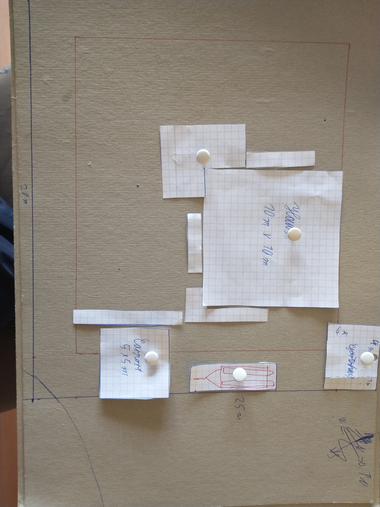

WilderSueden20 Nov 2020 16:16We spent some time working on the plan yesterday and this is the current attached version. Paths are not fully marked yet 😉
The carport has been reduced in size because the larger carport would lose its boundary privilege, which would require shifting everything quite far to the west. Also, the smaller carport still allows the house to be positioned more or less behind it rather than next to it. For a garden shed on the east boundary, there would still be 4 meters (13 feet) of continuous length available along the boundary, with a width of up to 5 meters (16 feet) feasible. This would also remain within the allowed 40 cubic meters.
Due to the short distances, an entrance on the east side would be convenient, with the added advantage that it is on the leeward side. With an entrance on the knee wall side, there would correspondingly be an east and west roof, which, to my understanding, is better for the photovoltaic system (aiming for self-consumption).
The terrace is planned for the southwest, but we are not fully decided on the exact corner yet; currently, both options are still considered 😉
For the internal floor plan, we need to get some inspiration tonight on the best way to arrange it. For variants with a basement, it is somewhat easier; without a basement, I see difficulties in fitting the office space in addition to the technical room.
WilderSueden20 Nov 2020 19:16Since we are not yet certain what kind of house will be built, we simply assumed a 10x10m (33x33 ft) footprint for now. However, this was definitely helpful to get an idea of the dimensions (and the boundary area).
The boundary area is also the issue with the carport. If I understand correctly, it can only be placed directly on the property line if it does not exceed 20 square meters (215 square feet). That would be exactly 4x5m (13x16 ft), which is quite tight for two cars. A practical solution is still needed here.
WilderSueden schrieb:
The boundary area is also the issue with the carport. If I understand correctly, I am only allowed to place it on the boundary as long as it does not exceed 20sqm (215 sq ft).By the way, where is that stated?https://www.instagram.com/11antgmxde/
WilderSueden20 Nov 2020 19:29Somewhere in a carport shop with the 20 m² (215 sq ft) outdoor area. At the same time, I have already tried to study the state building regulations of Baden-Württemberg.
§ 6
Setback Areas in Special Cases
(1) Within the setback areas of structural works, as well as without their own setback areas, the following are permitted:
2.
Garages, greenhouses, and buildings without habitable rooms with a wall height up to 3 m (10 ft) and a wall surface area up to 25 m² (269 sq ft),
3.
Structures that are not buildings, provided they are no higher than 2.5 m (8 ft) or their wall surface area does not exceed 25 m² (269 sq ft),
This would mean that a 5 x 5 m (16 x 16 ft) carport is allowed since the theoretical wall surface area would be 2 x 5 = 10 m² (107 sq ft). I am not sure whether it would fall under the garage category or as a "structure that is not a building." But in that case, it would need a building permit, right? And would I then need the neighbor's approval?
