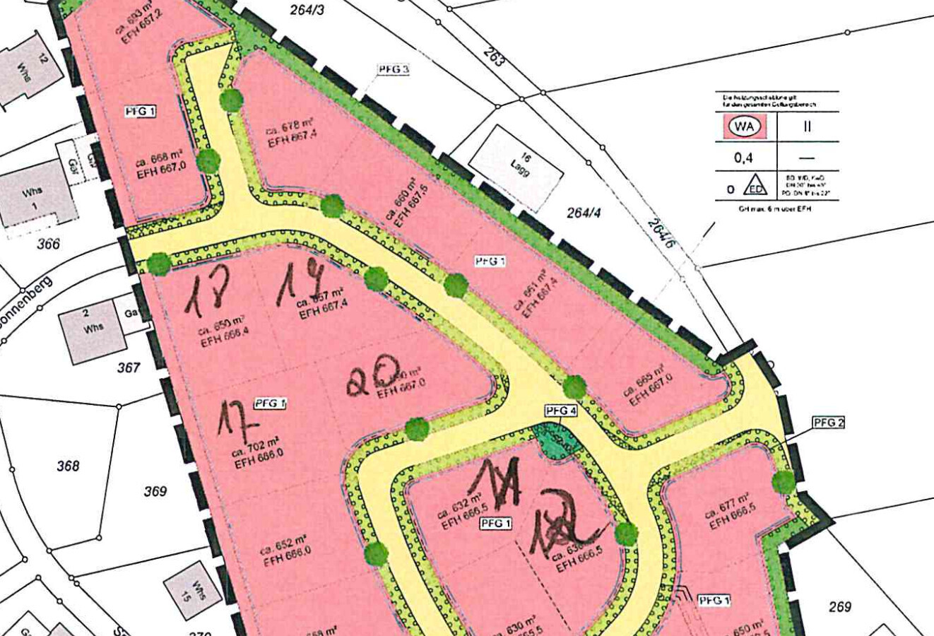

Regarding the development plan, so far we only have the graphical part; I still need to obtain the full text in the next few days. Our plot is number 17, and no major restrictions are noted here. Since the graphic is hard to read due to its size:
Floor area ratio 0.4
Open development, single-family houses and semi-detached houses allowed
Maximum 2 full stories
Maximum 6m (20 feet) for single-family houses
Gable, hip, and half-hip roofs probably pitched between 20 and 45 degrees
Building orientation does not seem to be regulated in at least the first part of the area (built 6 years ago), as the houses are rotated in all directions
The two undeveloped plots to the west (368, 369) belong to the garden of plot 367, so we have an unobstructed view in that direction. The location is at the edge of town on a hill.
From the plot, this results as a rough layout for us:
- Carport in the southeast corner with a rather small driveway (about one car length)
- House in the northeast corner, probably next to the carport
- Ridge likely oriented east-west, deviating only about 20 degrees from this axis
- Terrace facing southwest in front of the house to enjoy the free sun in the evening
