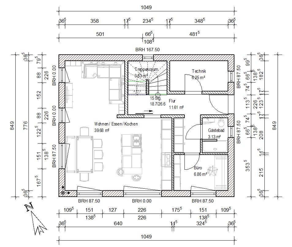

After a long search for a suitable plot, we have finally found one. We are buying a turnkey house from the developer, who provided us with three floor plan options. Two of them were immediately dismissed by us, and the third one comes closest to our ideas, but we are still not fully convinced.
We like the layout of the upper floor and would like to keep it as it is.
However, the ground floor is causing us some headaches. Specifically, the area around the living room/dining room/kitchen. The current plan features a U-shaped kitchen, but we would prefer a solution with a kitchen island. For that, we would need more space. In our opinion, there is too much space in the living room to accommodate this. The distance from wall to wall is 4.50 meters (15 feet), which, in our view, makes the distance between the sofa and the TV too large. (Note: Our current living room measures 3.40 x 4.50 meters (11 x 15 feet), meaning the distance between sofa and TV is 3.40 meters (11 feet), which we consider optimal.)
We have therefore considered swapping the living room and kitchen. This would allow the kitchen with an island to fit, but the living room would then be too small because the width there is only 2.80 meters (9 feet), due to the wardrobe recess. We do not see another place for the wardrobe, as the hallway does not offer much space.
We are hoping for suggestions or ideas for improvement.

Does it make sense to swap living room and kitchen (see problem description above)? If yes, where else could the wardrobe be placed without making the hallway too narrow? Is the office size still adequate?
We would appreciate any suggestions or ideas for improvement from you.

First of all, the 100% excellent thread opening has to be praised. It really brings together everything that people usually ask about in one place.
And it’s also fun to try out some ideas.
The hallway is too narrow at 110 cm (43 inches), and I also found the office too narrow with a room width of 180 cm (71 inches). The shower, if it’s to be included, is okay.
The utility room – what is supposed to go in there? The door is awkwardly placed.
On the upper floor, it would be better if both children’s rooms faced south, and the master bedroom should be arranged so that a wardrobe or similar furniture can still fit.
Anyway, I have done some rearranging.
The utility room is now on the east side, closer to the street, which might also reduce costs. It’s smaller, maybe sized so that a washing machine can be placed to the right near the window, and the stroller can be stored there. There’s space under the stairs for the vacuum cleaner and similar items, plus some storage for supplies planned.
The bathroom on the ground floor has been made smaller, enough for a 70 cm (28 inch) wide, floor-level shower and a small washbasin. The cloakroom serves as an anteroom to the office, which is now at least 215 cm (85 inches) deep. That’s enough space for a guest bed instead of a desk.
I’ve tried to optimize all doors so that a wardrobe can fit behind them wherever possible.
The living room is now in the northwest. The dining table has regular windows, so a bench can be placed on the terrace right under the window. The main access to the terrace is via the sliding door in the kitchen area.
The dressing room remains on the upper floor. If the window there is to be centered above the sliding door below, only reduced-depth wardrobes fit on the left side, while normal-depth ones fit on the right. Both again sized to IKEA Pax dimensions. The master bedroom now also fits a row of chests of drawers or even full wardrobes.
I added a narrow window to the upstairs bathroom and swapped the shower and toilet positions.
