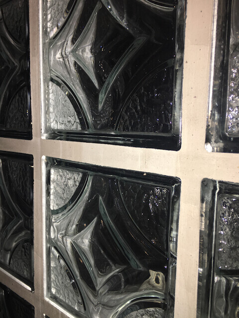

Next to the door, there is a section made of glass blocks – the joints are also damp on the inside.
