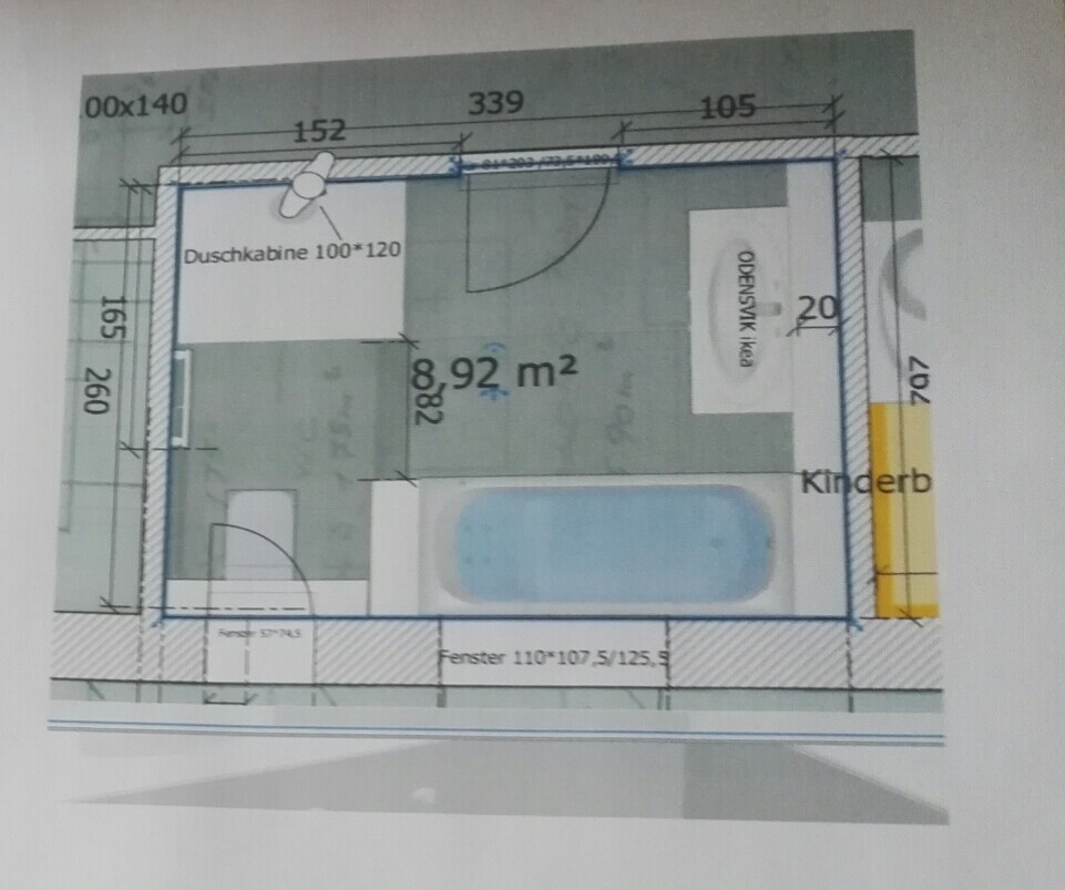

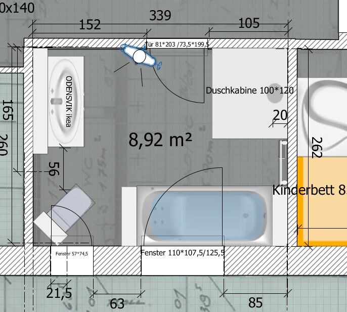

Hello, attached are the drawings of our bathroom design... one of them by a professional (with the round bathtub).
What do you think?
I have also included the dimensions of the bathtub... do you think it is really comfortable and large enough?!
Bathroom floor plan with shower enclosure 100*120, bathtub on the right, sink on the left, window, 8.92 m² (96 sq ft)
Bathroom floor plan: bathtub on the left, shower enclosure on the right, sink, window at the bottom
Bathroom floor plan: shower 100x120 cm (39x47 inches), bathtub on the left, window at the bottom, door at the top, area 8.92 m² (96 sq ft)
Bathroom floor plan with bathtub, sink, shower enclosure, window, 8.92 m² (96 sq ft)
Photo of a freestanding bathtub next to technical CAD drawings with dimensions.
Having a 120*100 cm (47x39 inches) shower and a comfortable bathtub is very important to us.

Hello Janine
Just like in the second example.
The toilet centered under the window.
As an additional suggestion:
The wall flush with the bathtub, up to the height of the window sill, and next to the toilet a urinal.
Olli
30 Apr 2016 19:54
Oh dear, a urinal in the family bathroom really isn’t necessary.
However, the layout in example 2 would make sense. I would extend the stud wall on the right and align the bathtub flush with the window. The open space between the toilet and bathtub could be designed as a platform at the same height as the bathtub. Personally, I would omit the privacy screen, as it unnecessarily reduces the size of the bathroom.
I would emphasize the two zones, bathing and toilet, with tiles, possibly adding a contrasting tile band between them on both the wall and floor. For the floor, this band could follow the shower line.

wrobel3 May 2016 10:27
Hello
Yes, this all looks quite neat.
