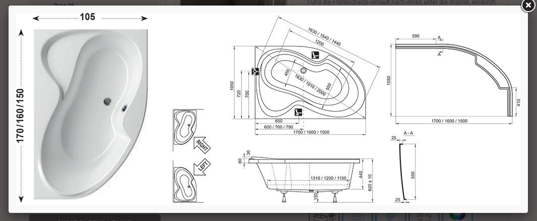

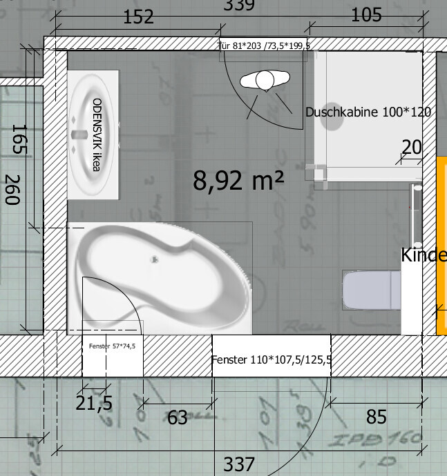

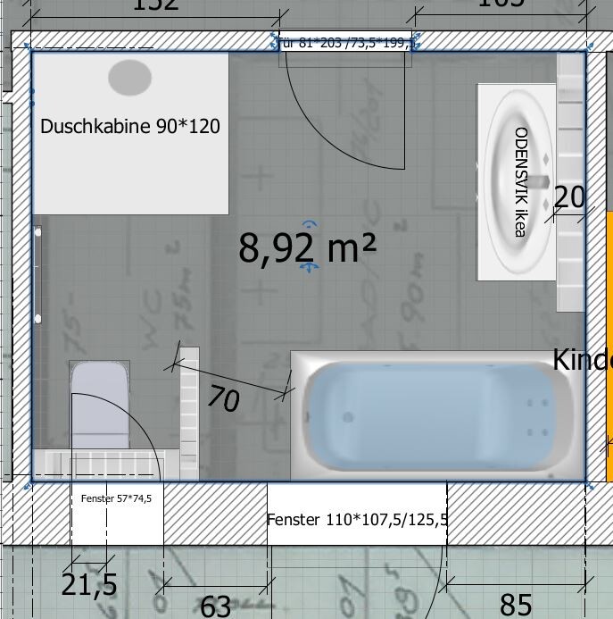

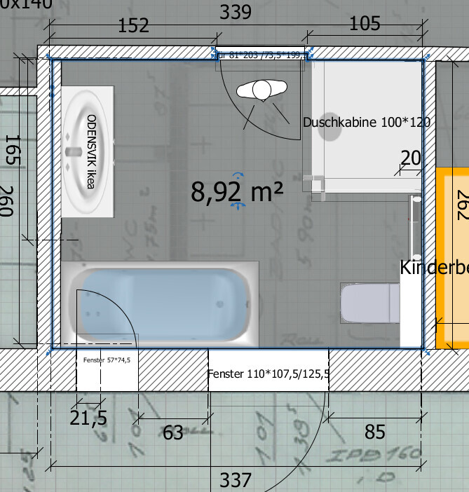

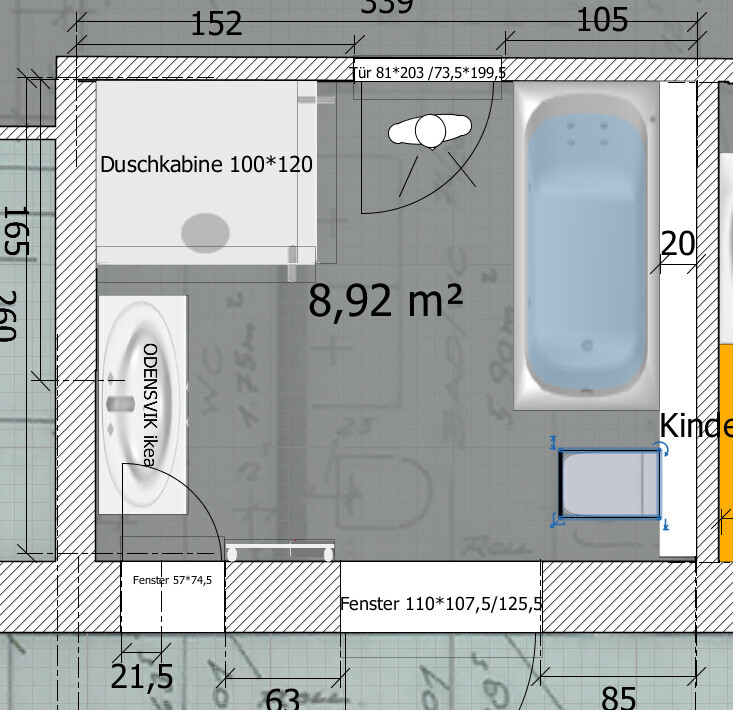

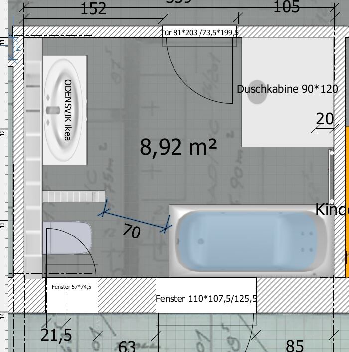

Hello, attached are the drawings of our bathroom design... one of them by a professional (with the round bathtub).
What do you think?
I have also included the dimensions of the bathtub... do you think it is really comfortable and large enough?!
Bathroom floor plan with shower enclosure 100*120, bathtub on the right, sink on the left, window, 8.92 m² (96 sq ft)
Bathroom floor plan: bathtub on the left, shower enclosure on the right, sink, window at the bottom
Bathroom floor plan: shower 100x120 cm (39x47 inches), bathtub on the left, window at the bottom, door at the top, area 8.92 m² (96 sq ft)
Bathroom floor plan with bathtub, sink, shower enclosure, window, 8.92 m² (96 sq ft)
Photo of a freestanding bathtub next to technical CAD drawings with dimensions.
Having a 120*100 cm (47x39 inches) shower and a comfortable bathtub is very important to us.

Is it a renovated older building? What are the window sill heights?

We are currently renovating an old building. The bathroom used to be both a bathroom and a guest bathroom, which is why there are two windows.
I’ll measure the window sill height shortly...
wrobel28 Apr 2016 15:10
Hello
I would reflect the two different windows in the room layout. Otherwise, it looks like an attempt that wasn’t successful.
For example, place the toilet under the small window with a partition wall toward the bathtub under the large window. Put the washbasin to the right of the door on the wall facing the children’s room. The shower can be to the left of the bathroom door.
Do the windows actually open in different directions? Are they older?
Consider replacing them at the same time.
Think about installing a decentralized ventilation system for the bathroom.
Olli
28 Apr 2016 15:31
As @wrobel suggests, that is also how I would do it: if the small window is placed a bit higher, it provides a separate space suitable for a toilet. The rest will follow naturally.

I can recommend the Kaldewei Mega Duo – very comfortable; also great for two people. It’s also water-saving.
We have the K. Vaio Duo in 210cm (83 inches), which has two sloping sides, absolutely top quality!

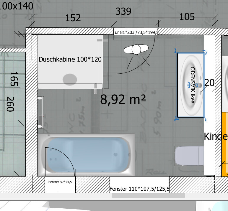

sorry, no, the windows do not open in different directions.
I’ve attached some options; is this what you meant?
Floor plan of a bathroom: sink on the left, shower enclosure 90 x 120cm (35 x 47 inches) on the right, bathtub at the bottom, window.
Bathroom floor plan: shower 90 x 120cm (35 x 47 inches) on the left, bathtub on the right, window at the bottom, area 8.92 m² (96 sq ft).
