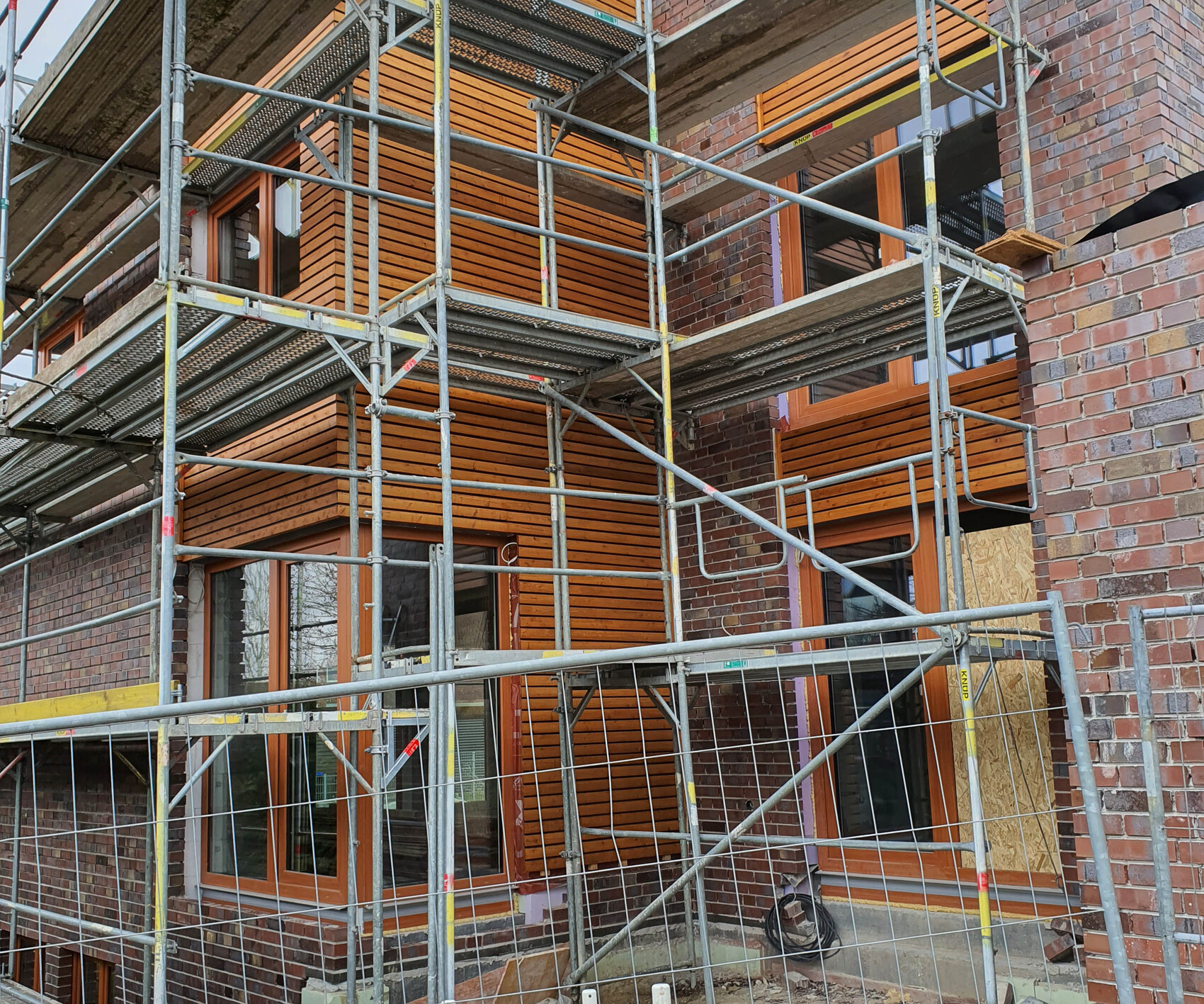

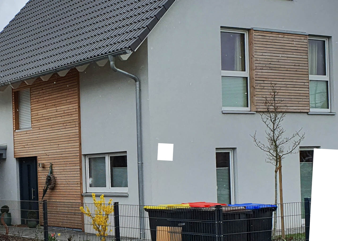

knalltüte5 Apr 2021 12:31For aesthetic reasons, wooden slats applied to the facade or on the external thermal insulation composite system (ETICS)—you probably mean rhombus cladding boards?—seem like foreign objects to me. I would recommend planning them to be as flush as possible, meaning integrated into the facade rather than mounted on top as separate elements. I am currently seeing both a very good and a corresponding negative example in our building area (mounted on top looks terrible, integrated looks great).
