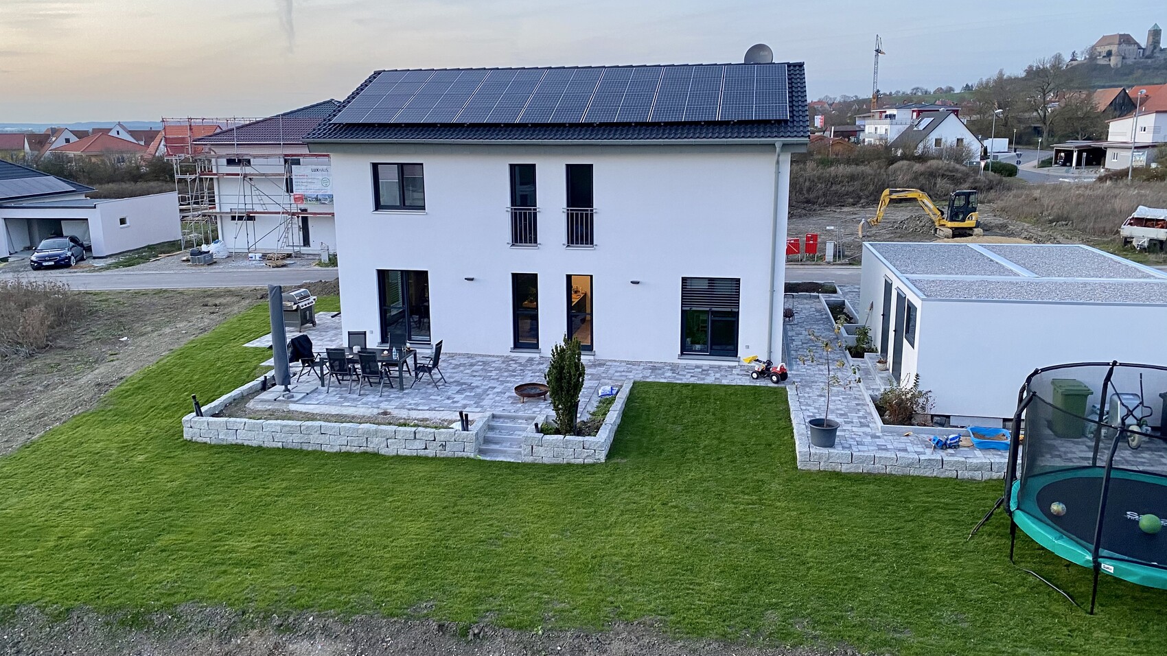

@Zaba12, this is our dry stone wall. It’s nothing extraordinary for a garden. We only backfilled with soil. The wall is 60cm (24 inches) and 40cm (16 inches) high; at 1m (39 inches) height, it might become critical, and you would need to use stones that fit better than the rather rough granite we used.
