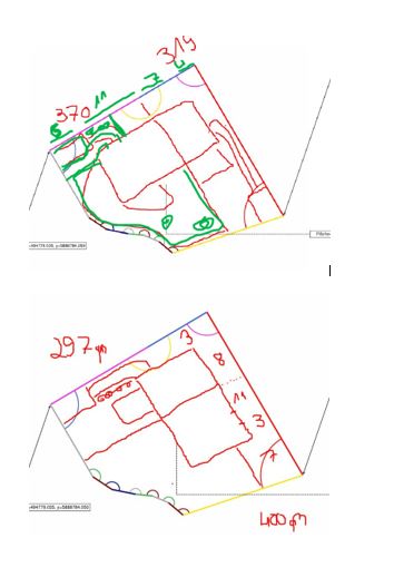

We have finally found a plot of land! I’m very excited to become active here from now on and hope to gain a lot of collective and practical knowledge. We are still at the very beginning. We plan to build a semi-detached house with a larger side for us (about 11x8m (36x26 feet)) and a smaller side (about 7x8m (23x26 feet)). Now we need to decide which side of the plot we should take. Does anyone have any tips?
It is a corner plot, and I have attached a sketch. The small black square at the top is the neighbor’s garden shed, and the large corner on the right is the neighboring house. The street to the west has a sidewalk, and the plots along that street generally have lower fences or hedges. I’m not sure if there are any regulations (such as a maximum height of 1.5m (5 feet)) regarding this. Opposite this street is just a pasture (farm). The street to the south has no sidewalk, and the plots there are very overgrown with tall hedges – usually there is a carport, a wooden gate to the property, and tall hedges along the street.
The corner plot itself is not perfectly rectangular; to the southwest there is a small public parking area (3 parking spaces). We would, of course, like to have as much of a “single-family house character” as possible. We would have the largest garden and more “quiet” if we position our side of the house to the north. However, this means for access either a very long, narrow driveway past the smaller house side (starting at the sidewalk) or a southern driveway, which I don’t really like because I don’t want the mail carrier to be able to look onto the terrace. If we choose our house side to the west, our garden is restricted by the public parking and possibly more overlooked (even upstairs), but this would allow a normal parking space and a normal front yard, and we would have neighbors on only one side, which can also be an advantage. What would you do?

Thanks to the discussions here, we have made significant progress with our considerations! We have decided that the tenants will definitely use a different entrance/facing a different street. Basically, there are only two options, see attachment (and please ignore the reference numbers I jotted down). We’re leaning toward the first version, and honestly, it’s purely a gut feeling; we just find that street somehow nicer than the other one, haha... The tenants can then choose to get a hand truck or anything else they want 😉 And if we really get annoyed by the neighbors on the terrace, at least we have the option to slip around the corner and enjoy the evening sun in peace. I am taking to heart the advice not to plan too tightly and will now create floor plans for the interior for both versions again.

My statement that it’s not that simple was mainly directed against ant’s wagon cart idea; as long as I can avoid that in the planning stage, I would like to do so. My "wagon cart idea" was simply a response to your complicated way of thinking about placing the owner-occupied half of the house next to the parking space because of a short carry distance. By the way, 11ant, dear vyn ;-)
