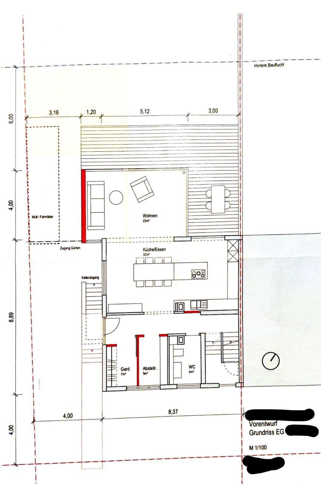

We are facing the exciting task of renovating and redesigning a semi-detached house in the city to create a modern and light-filled single-family home.

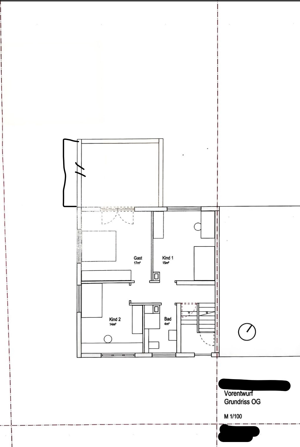

Our main focus is on the open, spacious communal area on the ground floor, which should offer a seamless connection to the terrace and garden. On the first floor, we plan the rooms for both children, a bathroom, and a versatile guest room or office.

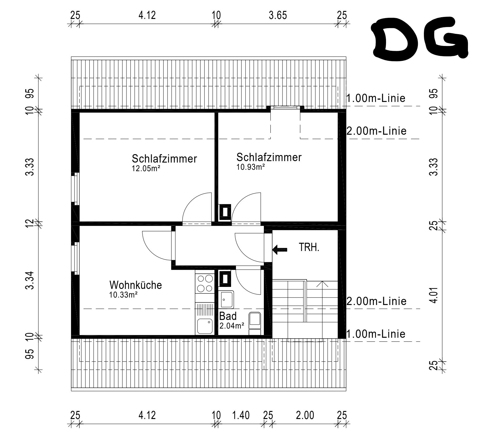

The attic should have the character of an open loft with an exposed roof space (removed ceiling to the attic) featuring floor-to-ceiling gable windows on at least one side, if not both, and serve as the parents’ area. (--> some walls on the ground floor and attic will need to be removed!)

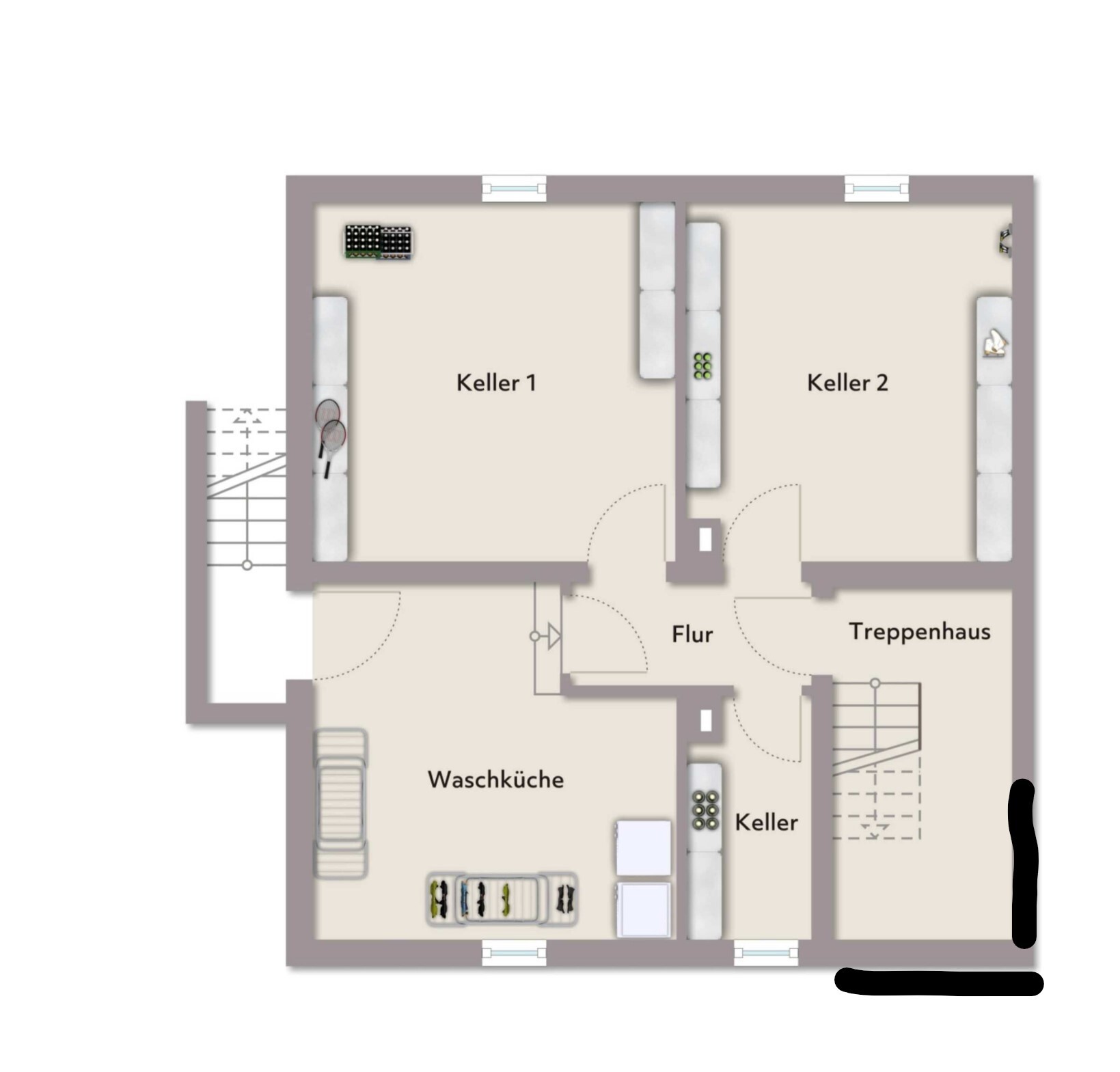

The basement will also be designed to be functional and open, with two separate rooms and an open area.
Efficiency and renewable energy are especially important to me in the design of this house.

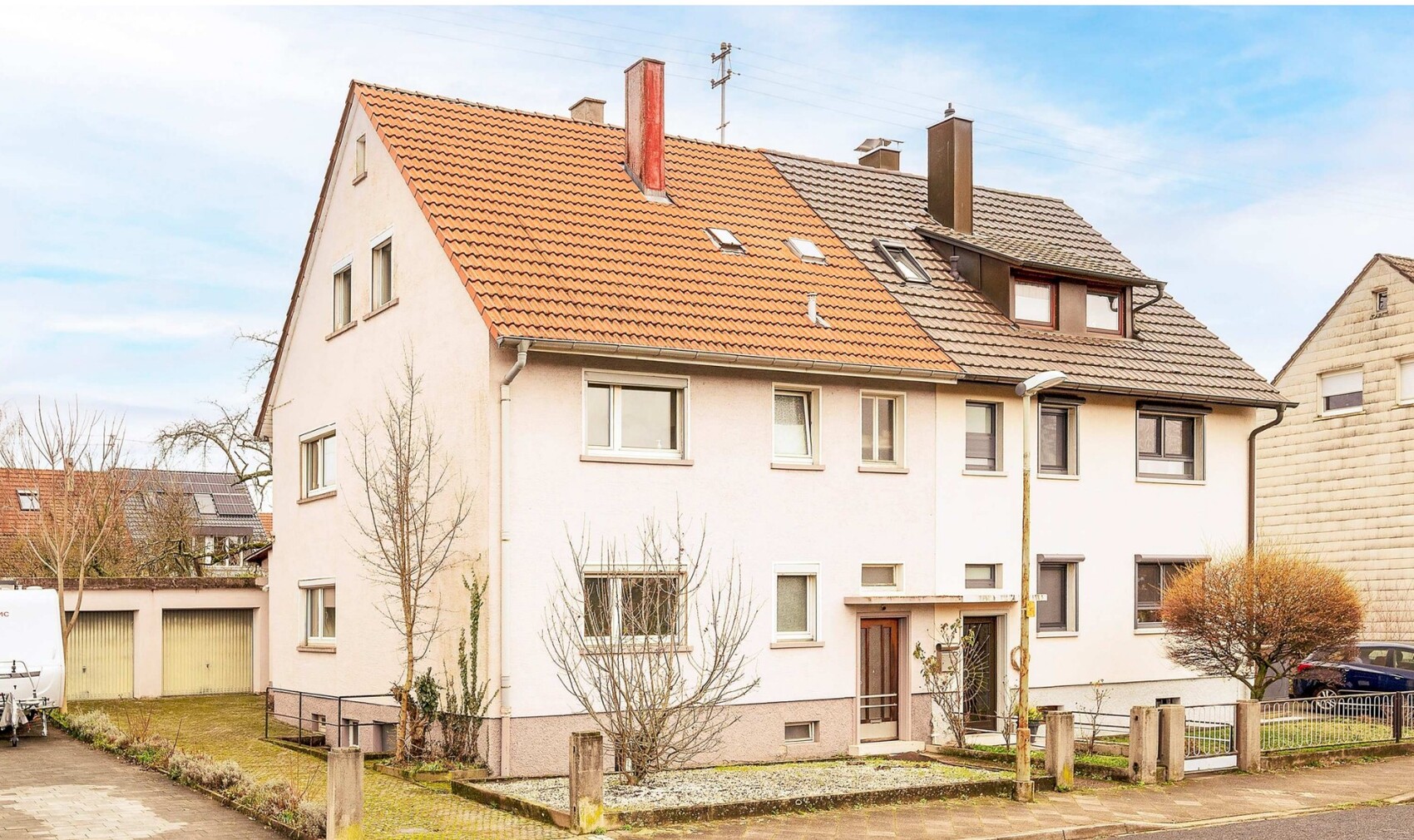

The semi-detached house dates back to 1954 and is in need of major renovation. It is fully connected to all utilities and fully basemented, built with solid construction and a pitched roof. The windows are made of plastic with insulating glass, and the energy certificate shows an annual primary energy demand of 312.4 kWh/(m²a), corresponding to energy efficiency class H. Heating is currently provided by stoves, a unit heating system, and instantaneous water heaters.
I am looking forward to receiving your feedback and ideas, especially since we are still in an early planning phase!

Attic floor plan: two bedrooms, kitchen-living area, bathroom, technical room, staircase
Basement floor plan with cellar 1, cellar 2, corridor, staircase, and laundry room.

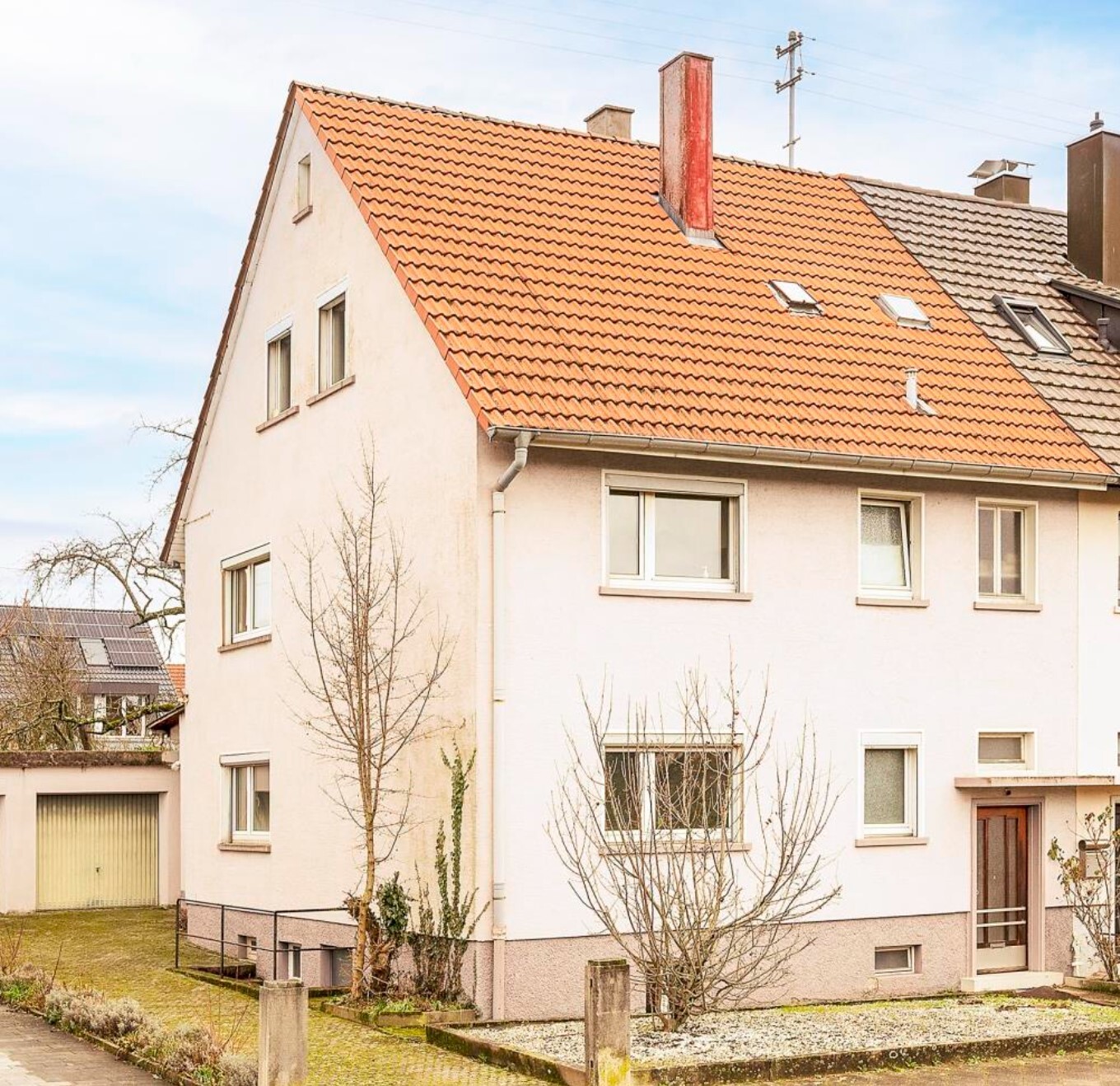

Multi-family house with red and gray tile roof, two floors, front garden, street side.

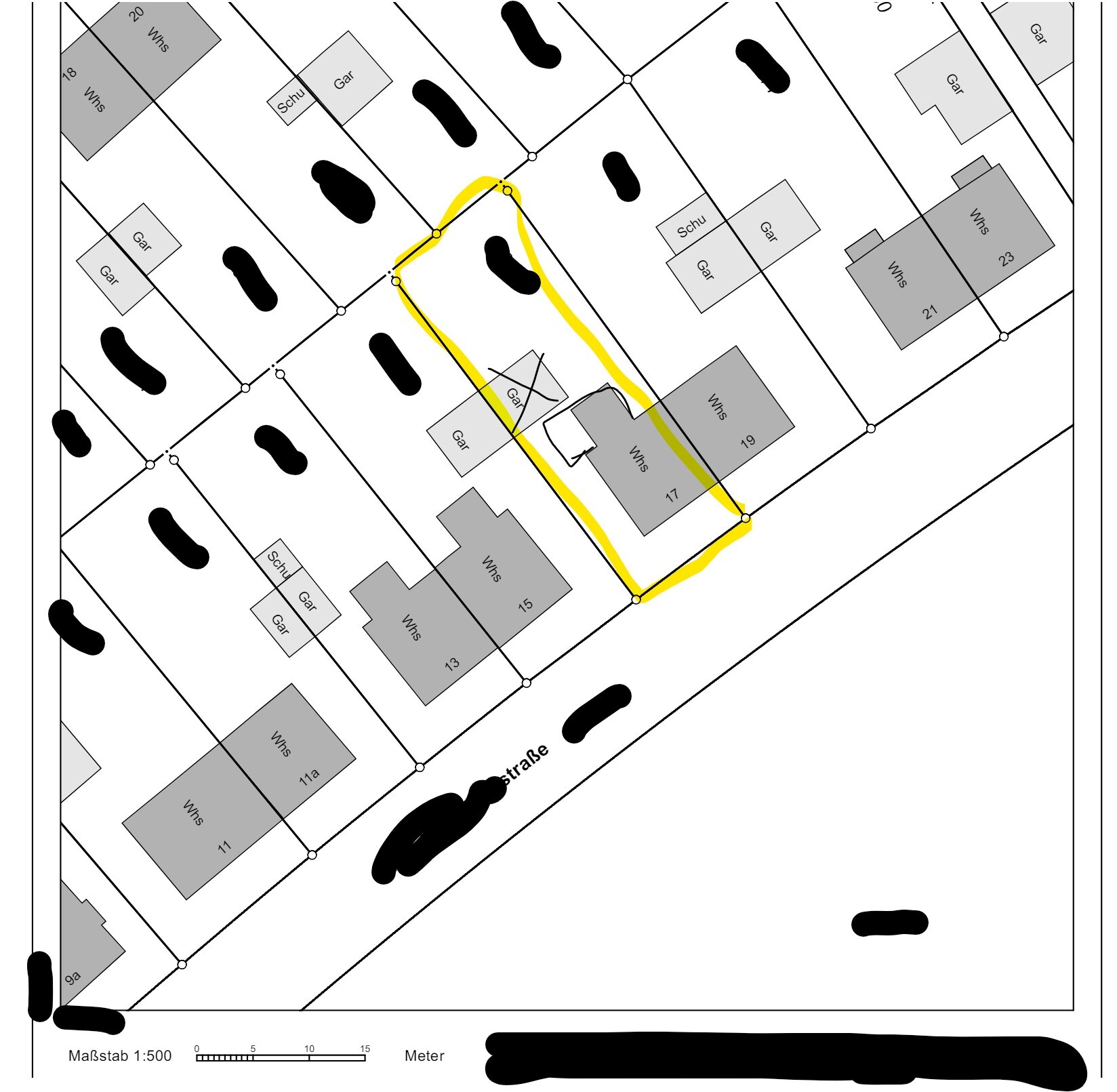

Site plan of a residential area: plot marked in yellow with buildings 17/19 on the street.
First floor plan: guest room 17 m² (183 sq ft), child 1 room 15 m² (161 sq ft), child 2 room 14 m² (151 sq ft), bathroom 4 m² (43 sq ft), staircase.
Ground floor plan: living, kitchen/dining, WC, storage room, cloakroom, terrace
Multi-family house with red tile roof, light beige facade and trees in the front garden.

Garages will be removed, so where will the parking spaces be located?

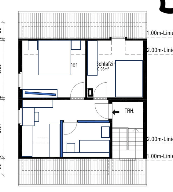

I really don’t like the attic floor. The two chimneys are unnecessary and should be removed. That would also improve the bathrooms. Is the plan to have a roof terrace on the upper floor?
hanghaus2023
9 May 2024 12:27
This is how I have envisioned it.
Floor plan of a multi-story residential house with bedrooms, hallways, and stairs.

In that sense, it’s quite well solved. I wouldn’t bring up parking regulations as the first argument, but I would also support keeping the garages—even if there is currently no car in the family.
What bothers me, though, is the completely open chill-out area. Not that I’m thinking conservatively, but a wall also provides structure, coziness, and privacy. That’s missing here. The TV lacks a back wall, and a privacy screen of 2–3 meters (6.5–10 feet) near the terrace would also help prevent views of stored items on the terrace. Therefore, I would suggest a 2-meter (6.5-foot) wall at the top left of the plan to provide privacy from the garage and shield the sofa area, as well as a 2–3 meter (6.5–10 feet) long wall by the terrace at the top right. These don’t necessarily need to reach all the way to the ceiling.
Furthermore, what would really bother me are the wet rooms: one on the ground floor is enough, one on the first floor could also suffice if the attic has a family-friendly bathroom to compensate. I wouldn’t argue against having a bathtub, since there are plenty of good reasons to keep it (medical baths, washing pets, soaking wool, cleaning groceries, or other hobbies—after all, people don’t just search Pinterest for things they already know).
Since the attic can’t really serve as a separate apartment, I tend to agree with @hanghaus2023’s version. I would arrange the whole attic as a family bathroom, and the office could be set up in the smaller bedroom.

Where will the parking spaces go once the garages are removed?
A parking space in the driveway is provided as a formality. We do not own a car and do not plan to have one.
