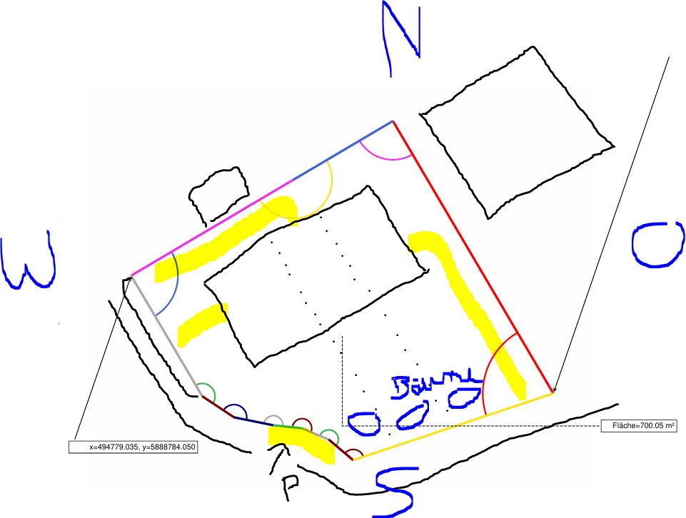

We have finally found a plot of land! I’m very excited to become active here from now on and hope to gain a lot of collective and practical knowledge. We are still at the very beginning. We plan to build a semi-detached house with a larger side for us (about 11x8m (36x26 feet)) and a smaller side (about 7x8m (23x26 feet)). Now we need to decide which side of the plot we should take. Does anyone have any tips?
It is a corner plot, and I have attached a sketch. The small black square at the top is the neighbor’s garden shed, and the large corner on the right is the neighboring house. The street to the west has a sidewalk, and the plots along that street generally have lower fences or hedges. I’m not sure if there are any regulations (such as a maximum height of 1.5m (5 feet)) regarding this. Opposite this street is just a pasture (farm). The street to the south has no sidewalk, and the plots there are very overgrown with tall hedges – usually there is a carport, a wooden gate to the property, and tall hedges along the street.
The corner plot itself is not perfectly rectangular; to the southwest there is a small public parking area (3 parking spaces). We would, of course, like to have as much of a “single-family house character” as possible. We would have the largest garden and more “quiet” if we position our side of the house to the north. However, this means for access either a very long, narrow driveway past the smaller house side (starting at the sidewalk) or a southern driveway, which I don’t really like because I don’t want the mail carrier to be able to look onto the terrace. If we choose our house side to the west, our garden is restricted by the public parking and possibly more overlooked (even upstairs), but this would allow a normal parking space and a normal front yard, and we would have neighbors on only one side, which can also be an advantage. What would you do?

It might be better to orient the house differently, for example by rotating it so that the gardens face west. This might also allow all the parking spaces to be positioned closer to the street with only a walkway leading to the front door. This approach has proven practical on many smaller plots, especially where access is from the south.
If possible, it would make sense to create basic templates for the house, entrances, terrace, and parking spaces to experiment with different layouts.
Try to free yourself from the concern about having only a few parking spaces on what seems to be a quiet residential street—you usually don’t notice it. No one stands around staring into other floors. Floor-to-ceiling windows facing the street are generally avoided anyway. The postman will appreciate a mailbox at the front near the beginning of the property. There is always a good Plan B instead of adopting a standard cookie-cutter approach.

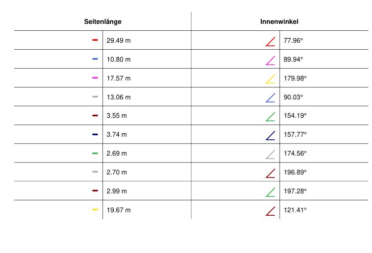

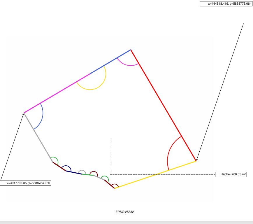

I am attaching the documents I have. The notary appointment is scheduled for next week. Currently, the plot is a parking lot, and I prefer not to share the exact address in a forum. The local authority has approved the conversion of the parking lot into building land. The application included a sketch that also showed two access points. The development plan is: Lower Saxony, one full floor, 0.4 plot ratio, 0.6 floor space index, only single-family or semi-detached houses allowed. According to my research, we need 3 parking spaces for a semi-detached house, but I have not yet received official information on this. We are planning a large half of a semi-detached house for our family (2 adults, 2 children) and a classic narrow semi-detached half for rental. I am somewhat concerned that we will cast a shadow over the neighbors’ southwest-facing terrace.
In the lower left, there is a tall English oak tree that must not be cut down.
